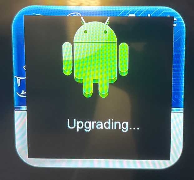

How long do I have to keep pressing the recovery button? I have kept pressing it for about 3 minutes and I still can’t get the CoreElec screen to appear. Instead, now below picture is in a loop for being displayed for about 20 seconds and goes for 5 seconds and then appear again. What else could be wrong?

The CoreELEC installation probably overlaps with the Android recovery or an Android update.
I would first remove the SD card or USB stick and repair the original Android. Only once that’s working again can you proceed with installing CoreELEC from the SD card or USB stick.

Make sure you are pressing the correct button labeled ‘Recovery’ and not the other one (Maskrom).

Reflashing firmware from recovery menu:
Insert usb flash drive with OTA update package in Box
Hold recovery button and turn on the device
In recovery menu choose option “update from ext”

You repair your system with version 0.4.1, then start Android TV and let the system update automatically over the internet. All without a USB cable and only takes a few minutes.
