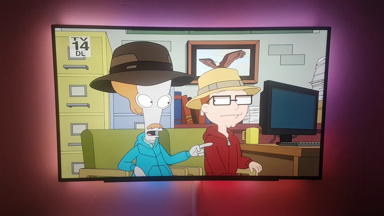

I did as you told me and the slowing down seems to be gone, but (with the same settings in my hyperion.config.json) i get a sort of flickering.
Here you can see what I mean:
here is my log:

I could not see any flickering or any annoing thing. so GUI is “fine/smooth enough” for me.
I am totaly happy how hyperion performs now
(live tv for about 2-3 hours and NO SINGLE SLOWDOWN, amazing!!)
