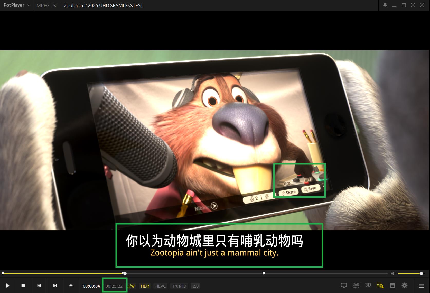

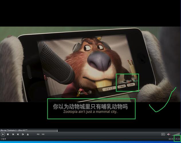

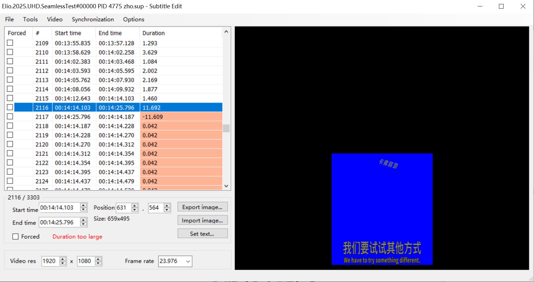

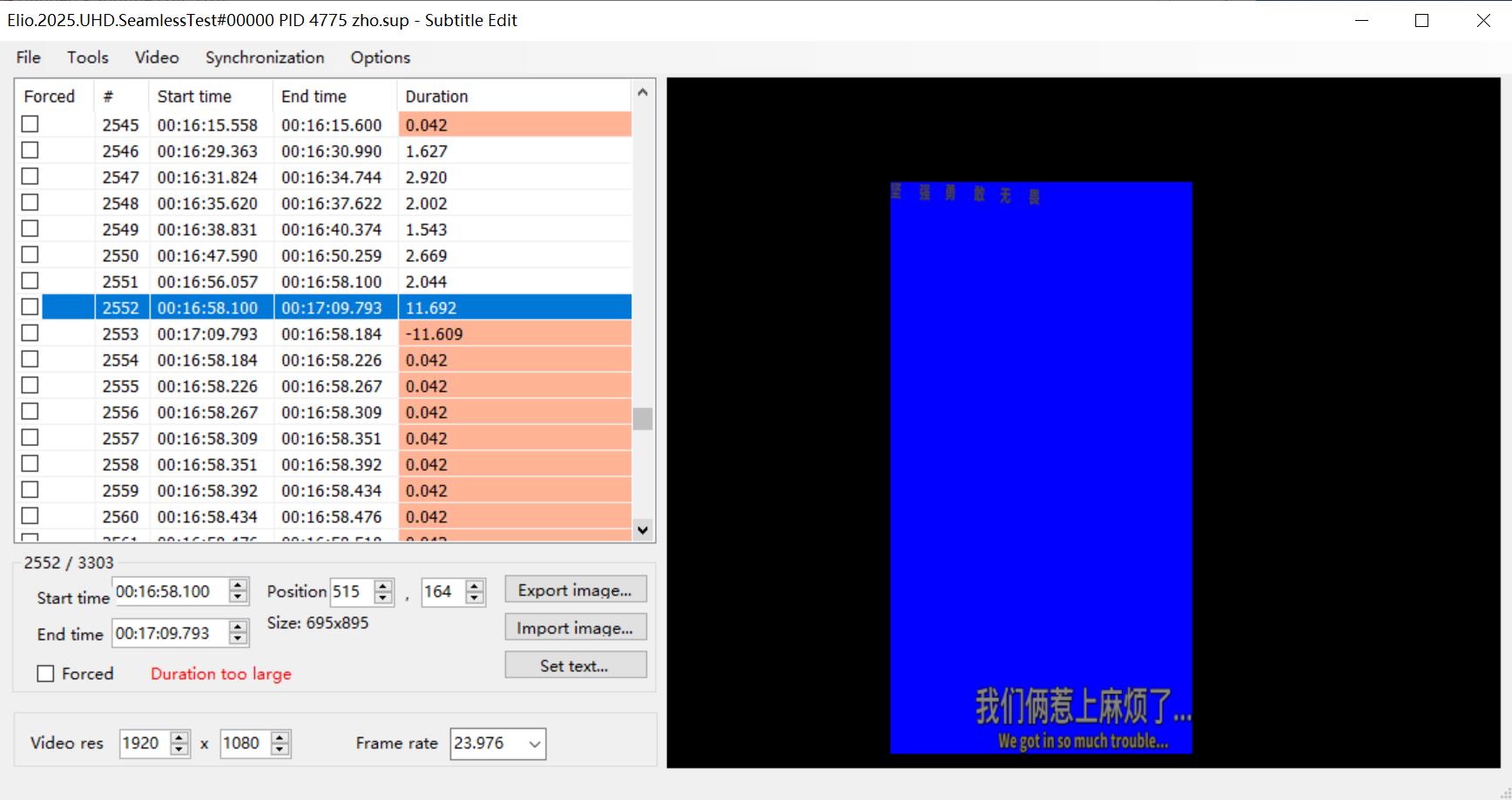

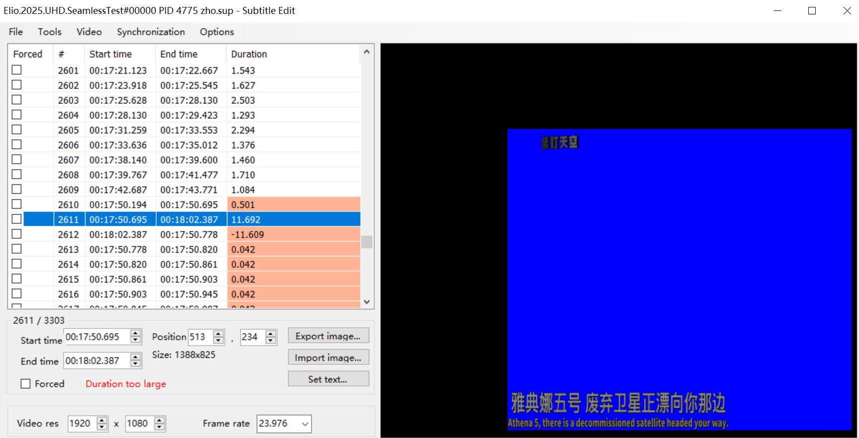

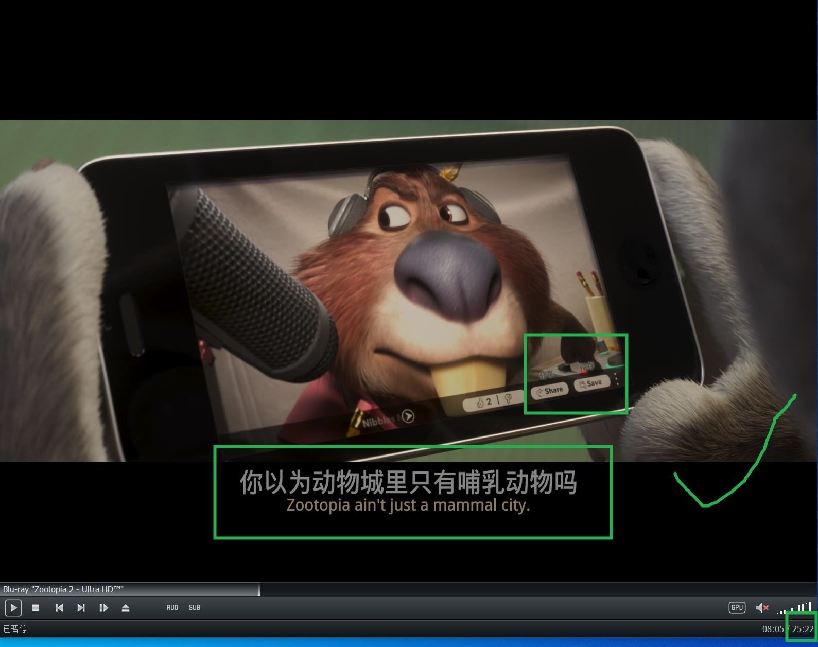

CE did not display the subtitles according to the timeline. The correct display should be from 00:17:50 to 00:17:52, but CE incorrectly displayed the subtitles from 00:17:20 to 00:17:52,The other two also do not display subtitles according to the timeline.
Forgot to make a mark, the subtitles at the OSD mask are also incorrect
PotPlayer MPC-BE display the subtitles correctly.

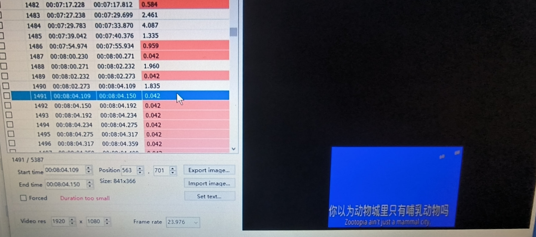

The sample is approximately 20 minutes long and contains 11 subtitles. Please select the 8th subtitle.
Edit:Add screenshots of subtitles and key timestamps extracted from the video
subtitle link:

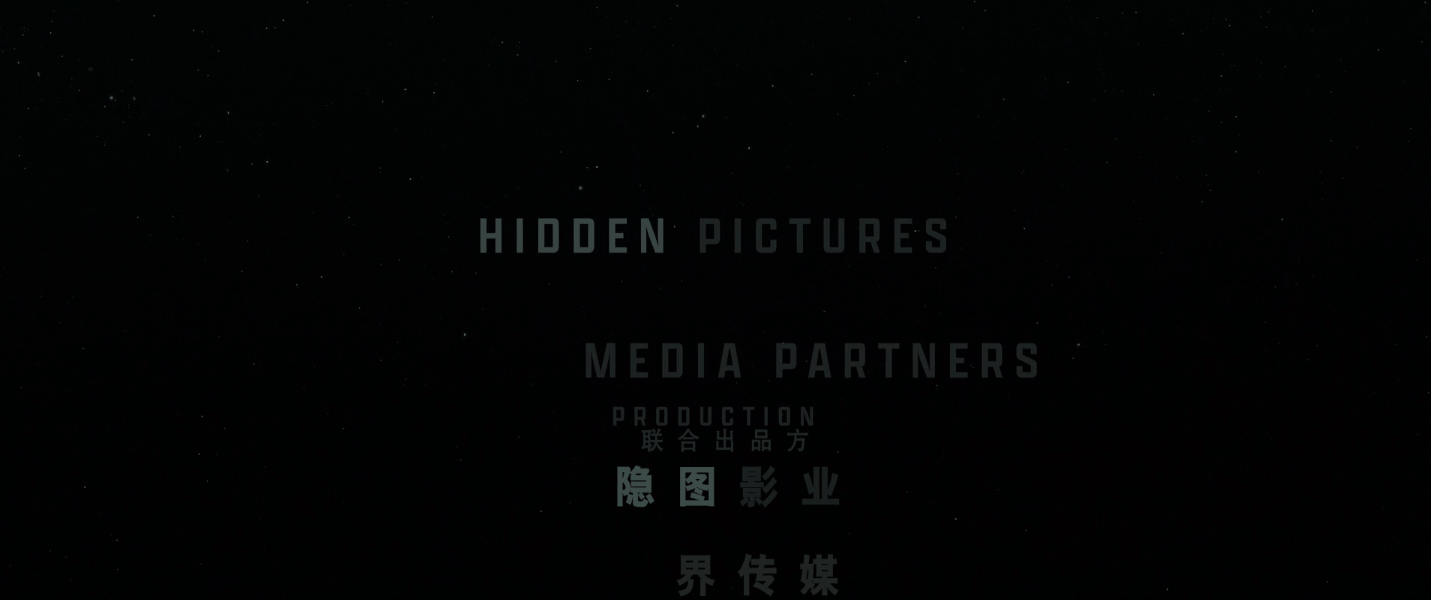

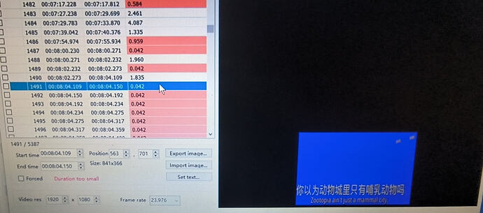

Regarding the subtitles, which are being discussed here: We have the Dune 2 movie, where the German PGS subtitles are displayed directly over the hardcoded English ones.
With the AM9 Pro, the German subtitles now disappear slightly too early, so the English ones always flash briefly and remain readable.
This wasn’t the case with non CE22-NO Builds on AM6B Plus.
We’re probably only talking about milliseconds here.

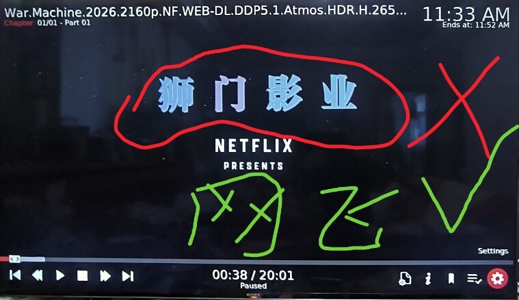

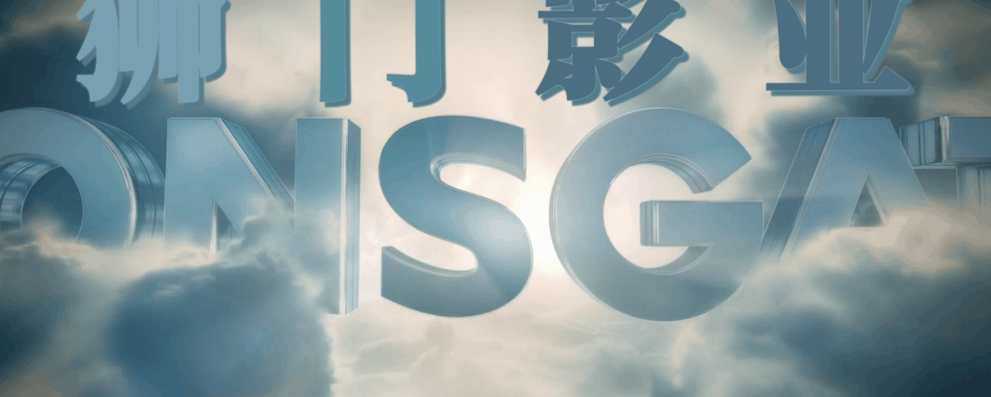

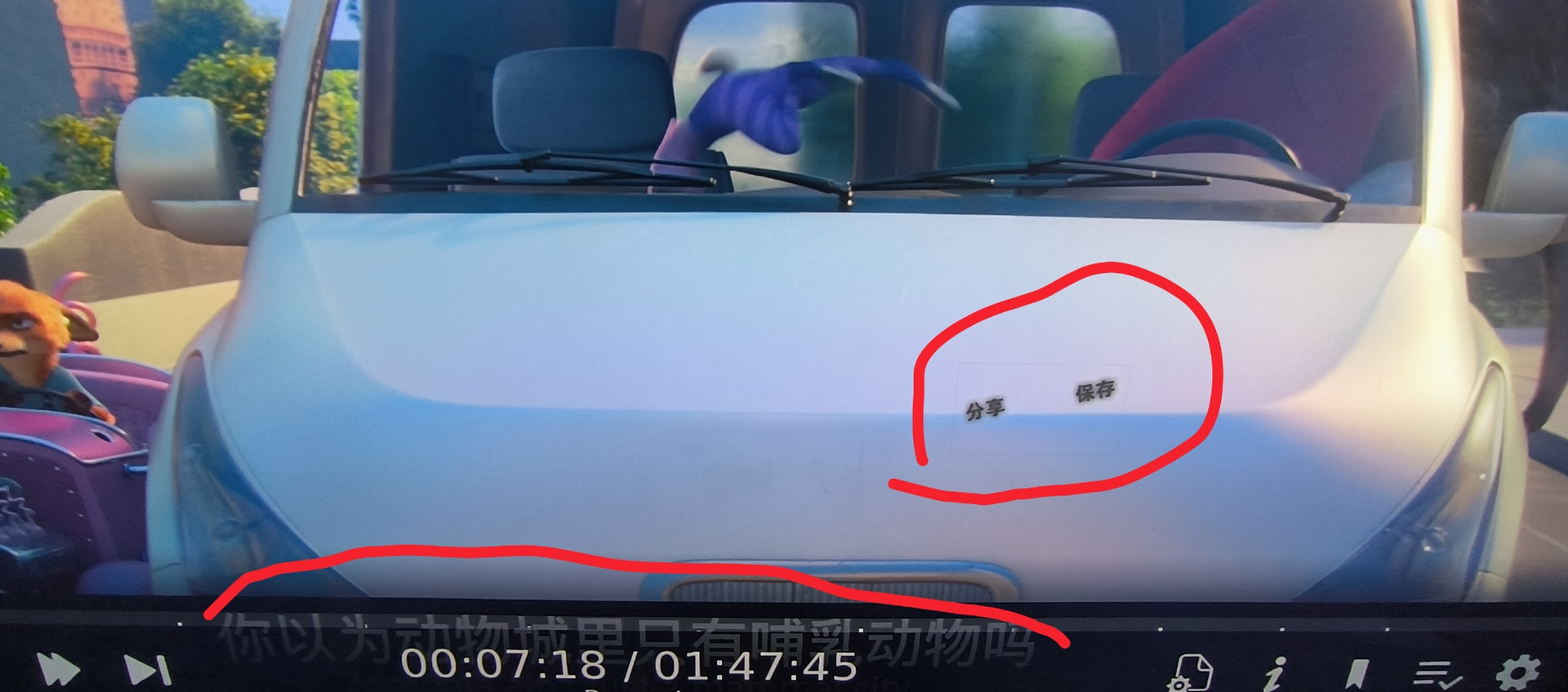

There are too many mistakes, here’s just one example
CE’s support for external subtitles still can’t match Android Kodi. The subtitles are delayed, whereas normally, hard-coded subtitles should appear and disappear at the same time as soft subtitles.
It should be displayed like this

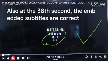

The test sample also has embedded subtitles, and the content is exactly the same as the external subtitles. The embedded subtitles work fine, so we need to make sure it’s loading the external subtitles.The first minute wasn’t in sync, The device is homatics.
