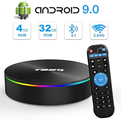

Can you please let me know if there is a device tree available for T95Q?
I’d like to know too. Thanks in advance.
The device trees we have are generic, so it should, in theory, work with the ones we already have in our builds.
But the RGB LED around the device won’t work, as there is no driver for it.
In addition to that, we’ve seen a lot of Ethernet issues from T95Z boxes in the past. I’m not sure if that could still be a problem, but keep it in mind when making a purchase.
