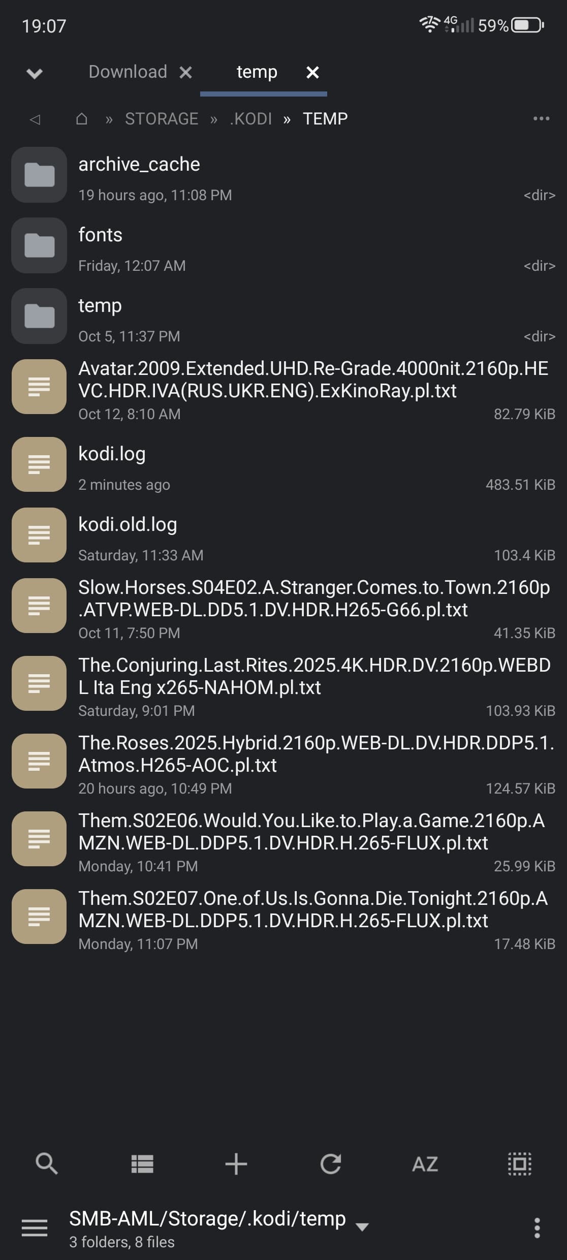

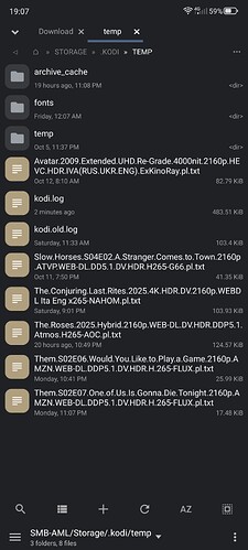

No, it’s Not. On my Hisense TV AM6B+ with CE 21.2-NG, DV (P5, P7FEL/MEL, P8.1) works perfectly!!!
To add, FR and resolution switching works instantly; also picture quality not comperable with inferior on Fire 4k TV sticks…
