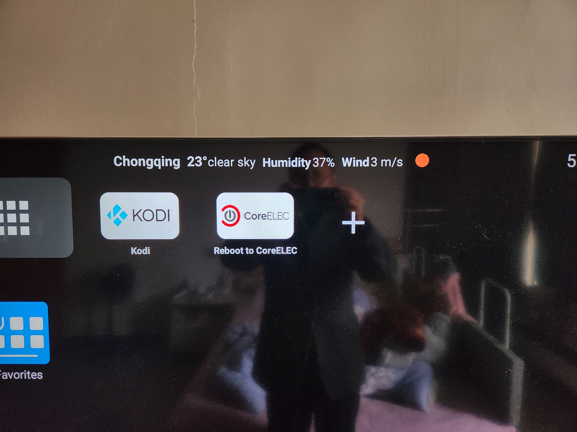

I noticed a major hurdle for our debugging:
Even if I issue the reboot command within the CoreELEC terminal, the device reboots directly into Android instead of returning to CoreELEC. I have to manually select “Boot to CoreELEC” from Android every time to get back, which causes the Terminal Sharing service to disconnect and makes consistent debugging very difficult.
It seems the boot priority isn’t sticking during a warm reboot on the AM9 Pro. Let me know how you want to handle this.

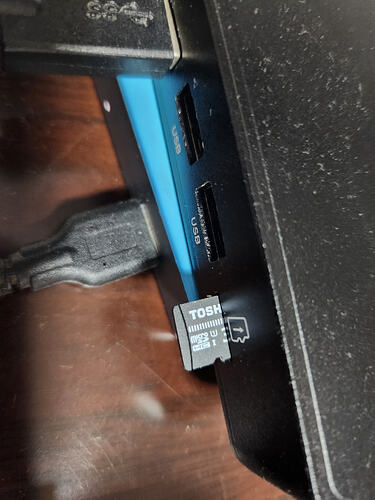

Use µSD instead USB. Android bootloader have a boot bug and does not detect USB storage on warm boot.
Known issue without solution yet. Use poweroff and then start it again.

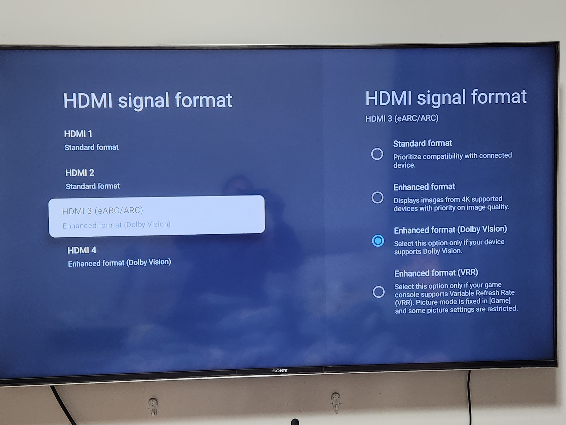

You have AVR between TV & CE device?
Only DV 2160p30hz maximum…
AVR mostly don’t like DV signals! Use (e)ARC with passthough instead.

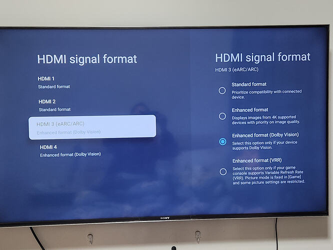

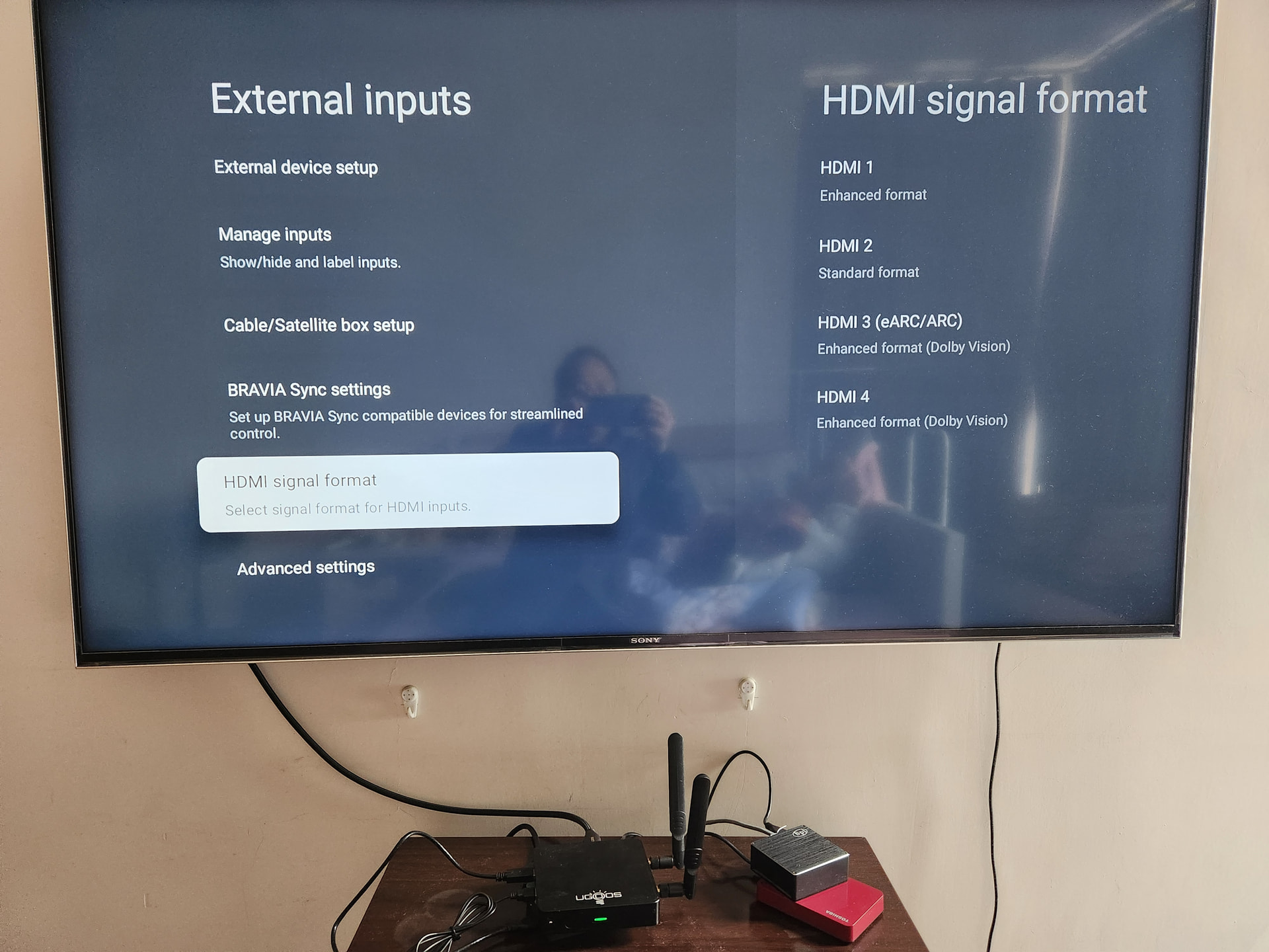

​Hi @Portisch and @Vpeter,
​Thank you for the suggestions. Here are the updates based on my testing:
​Direct Connection (No AVR): As shown in my previous photo, I am connected directly to the Sony X9500H via HDMI 3 (eARC). There is no AVR or soundbar in between. On my S905X3 box, this same setup provides 4K 60Hz DV without issue. The fact that the S905X5 only detects 2160p30hz suggests an EDID or handshake bug in the current S905X5 kernel.
​Boot Issue (Power off vs Reboot): @Vpeter, I tried using the poweroff command and then starting the device again as you suggested. Unfortunately, it still boots directly into Android. On this Ugoos AM9 Pro, neither a warm reboot nor a cold boot (via poweroff) seems to respect the µSD boot priority once it has been in CoreELEC.
​Hardware Status: I will leave the device powered on and the Terminal Sharing (wangyu1314) active so you can continue to investigate these VPU/HDMI and Bootloader issues directly.
Wrong HDMI port, this is for the soundbar. Try other ports. You see in display info what formats are supported by your TV.
No bug, your TV just don’t support it.
My TCL does report 2160p60hz and it works.

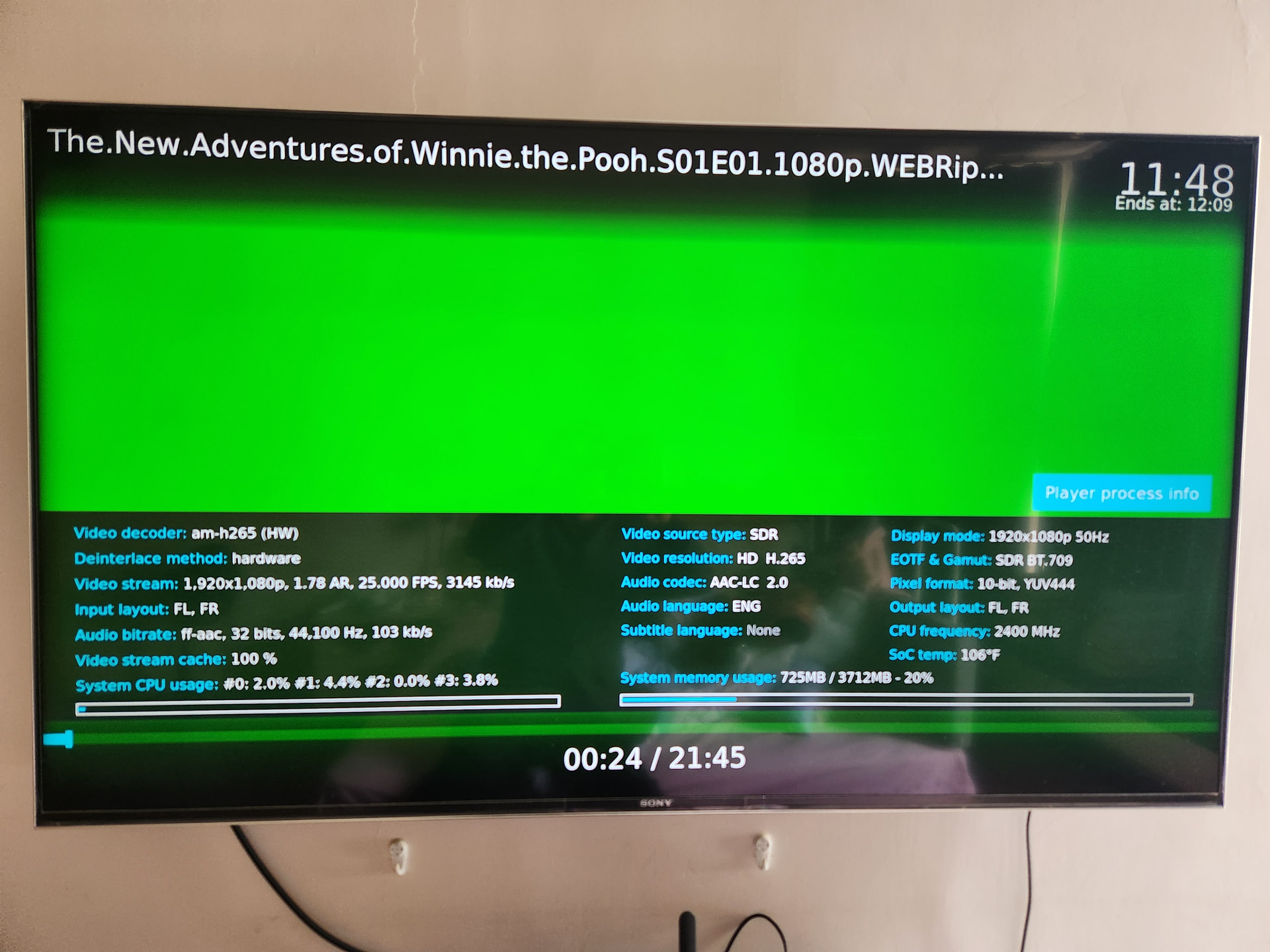

​@Portisch,

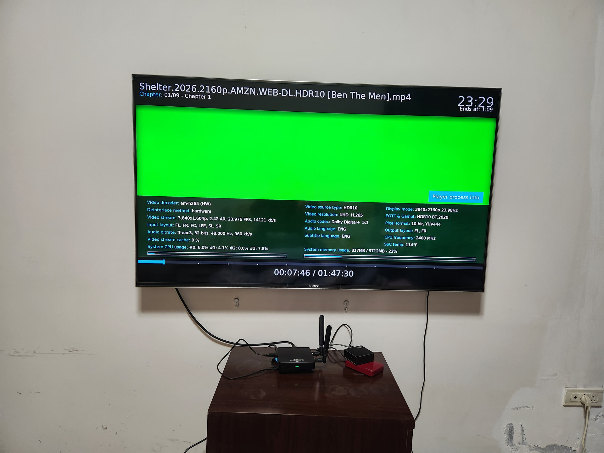

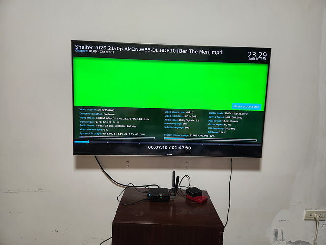

​Now that we have confirmed the HDMI 3 port and Sony TV are correctly configured for 4K 60Hz (as shown in my previous photos), let’s look at the actual core issue.
​I have attached a photo of the Green Screen occurring during playback of a standard 4K HDR10 file.
​Hardware Decoder: am-h265 (HW) is active.
​Resolution: 4K UHD.
​Result: Complete green screen (VPU failure).
​This proves that even with the “Enhanced Format” enabled on the TV and the correct HDMI handshake, the S905X5 kernel/driver is failing at hardware decoding.
​This is the real bug I’ve been trying to report. It’s not the cable, not the port, and not the TV—it’s the VPU implementation on this new SoC. Please use the log from my Terminal Sharing session (wangyu1314) to investigate this decoding failure.
Furthermore, in this green screen state, the decoding performance is abysmal. The playback is constantly stuttering or completely freezing.
​This suggests that the VPU is not just outputting wrong colors, but is likely crashing or failing to manage the buffer at the kernel level.
​To recap:
​Android works perfectly (Same hardware, same TV, same file).
​CoreELEC fails with a green screen and total playback stagnation.
​This is a textbook case of a broken hardware-accelerated video driver in the current S905X5 build. I hope these details help you pinpoint whether it’s a memory allocation issue or a VPU clocking bug.

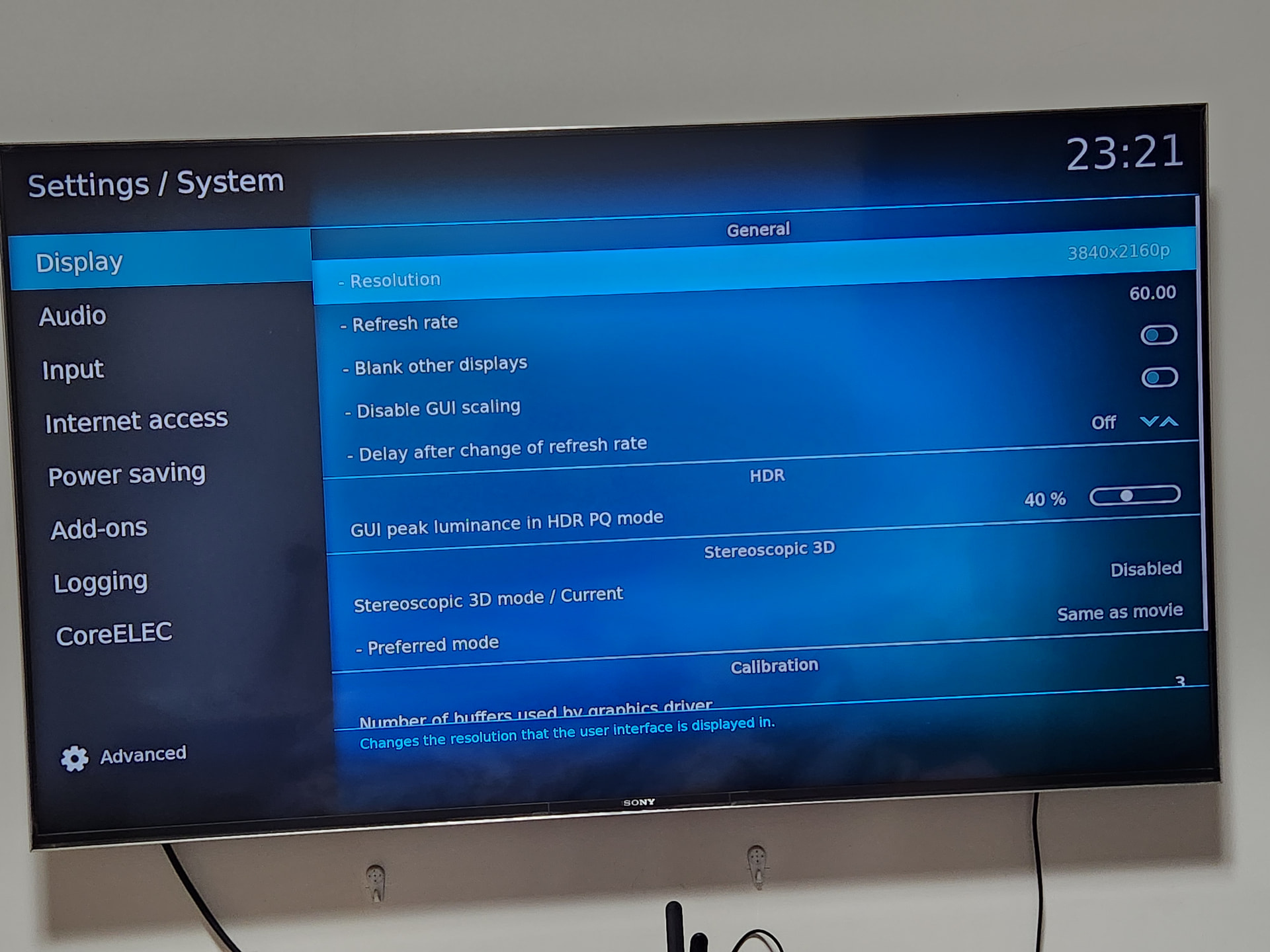

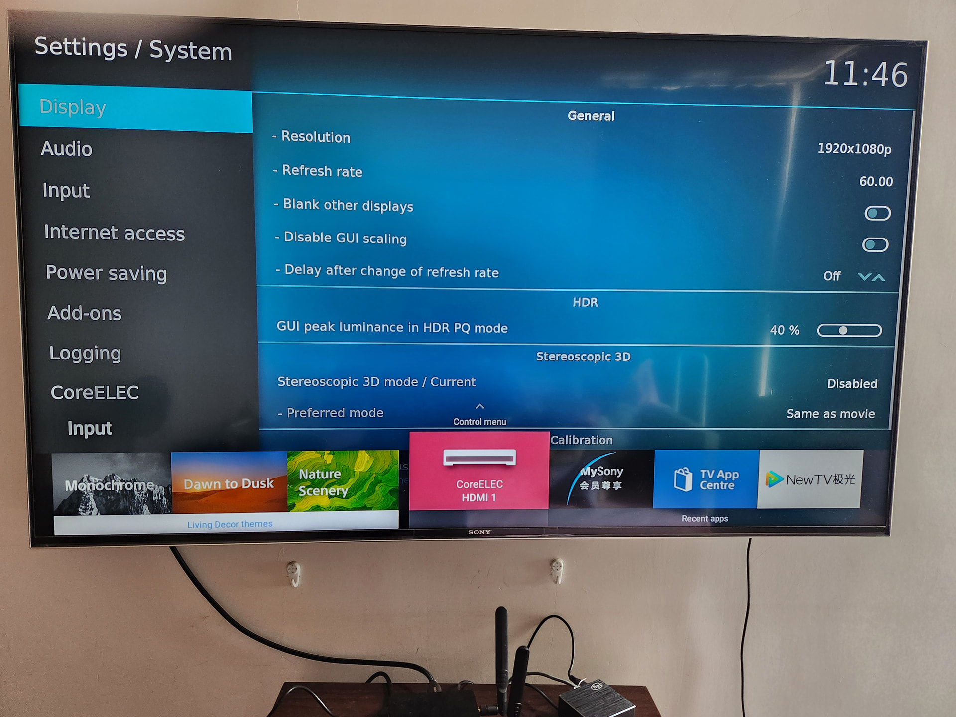

  1. Did you try HDMI1 without any special setup? Without force any HDR!
  2. Did you share any media sample?
  3. Did you try with GUI set to 1080p? This is highly recommend!

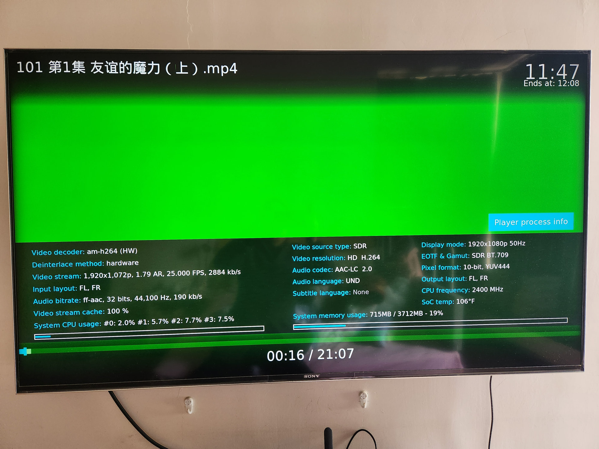

​@Portisch,
​I have followed all your suggestions, and the results clearly point to a hardware initialization failure in the CoreELEC kernel for S905X5.
​Test Setup as requested (See attached photos):
​HDMI Port: Switched to HDMI 1 (Standard/Enhanced mode).
​GUI Resolution: Set to 1080p 60Hz.
​Media: Tested various samples, including non-HDR H.264 and H.265 files.
​The Results:
​The Problem Persists: Every single file results in a GREEN SCREEN and extreme decoding lag (as shown in the Player Info overlay). It doesn’t matter if it’s 1080p or 4K, HDR or SDR.
​The “Sleep” Trigger: If I put the device to sleep/standby using the Sony remote and then wake it up, every video becomes green.
​The “Android” Proof: All these files play perfectly on Android firmware using the exact same hardware and HDMI 1/3 ports.

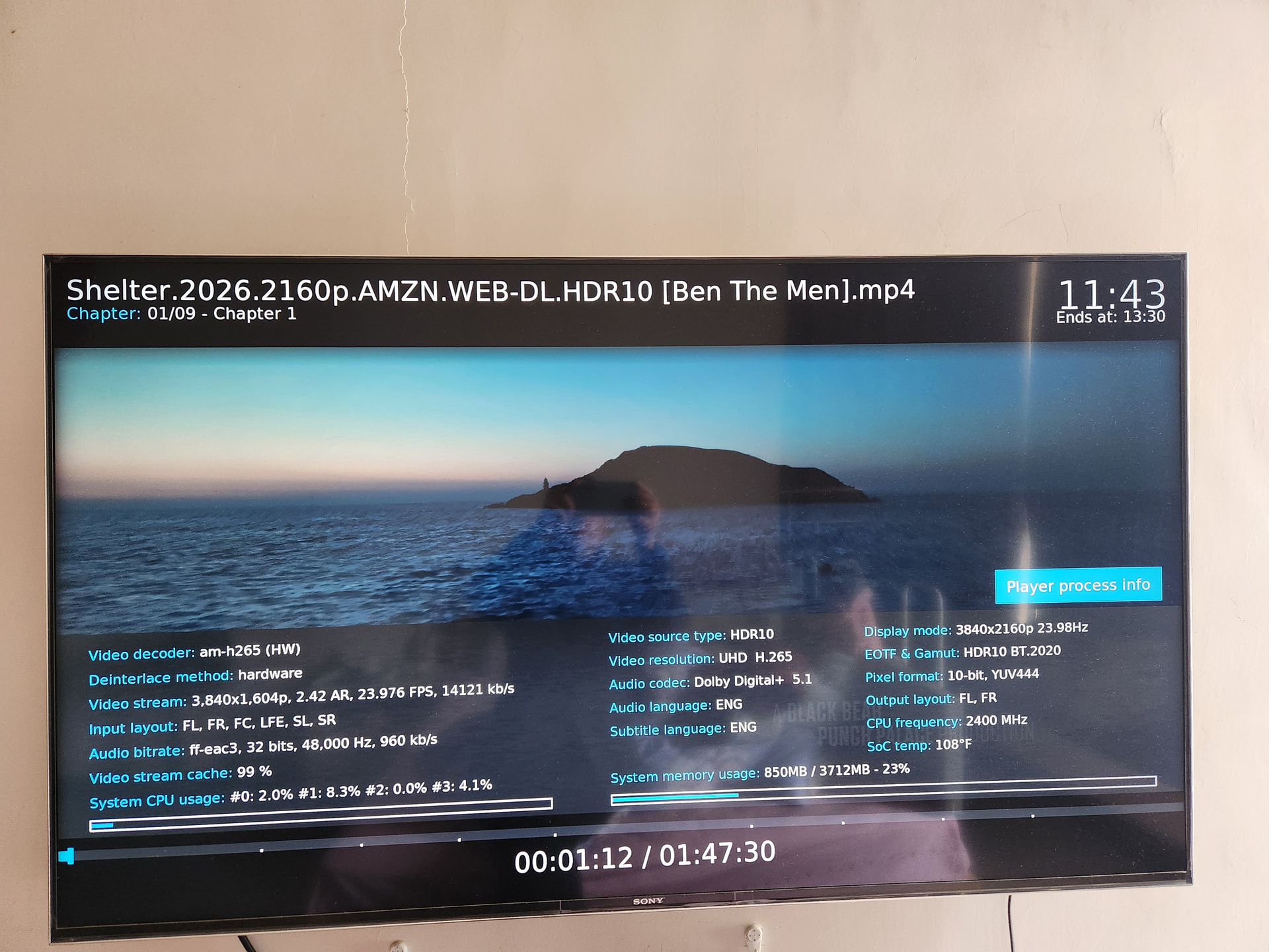

​The “Warm Boot” Logic: If I reboot into CoreELEC directly from Android, the FIRST playback is normal (see the successful 4K playback photo). But after one playback or a standby cycle, it breaks completely.
​Conclusion:
This is NOT a TV setting issue, NOT a cable issue, and NOT a media sample issue. The fact that it works after an Android reboot but fails after a CE cold boot or sleep cycle proves that CoreELEC is failing to correctly initialize or reset the VPU/HDMI registers on the S905X5. The evidence is now undeniable. I have provided the logs and the visual proof. It’s time to look into the kernel’s VPU/HDMI driver implementation.

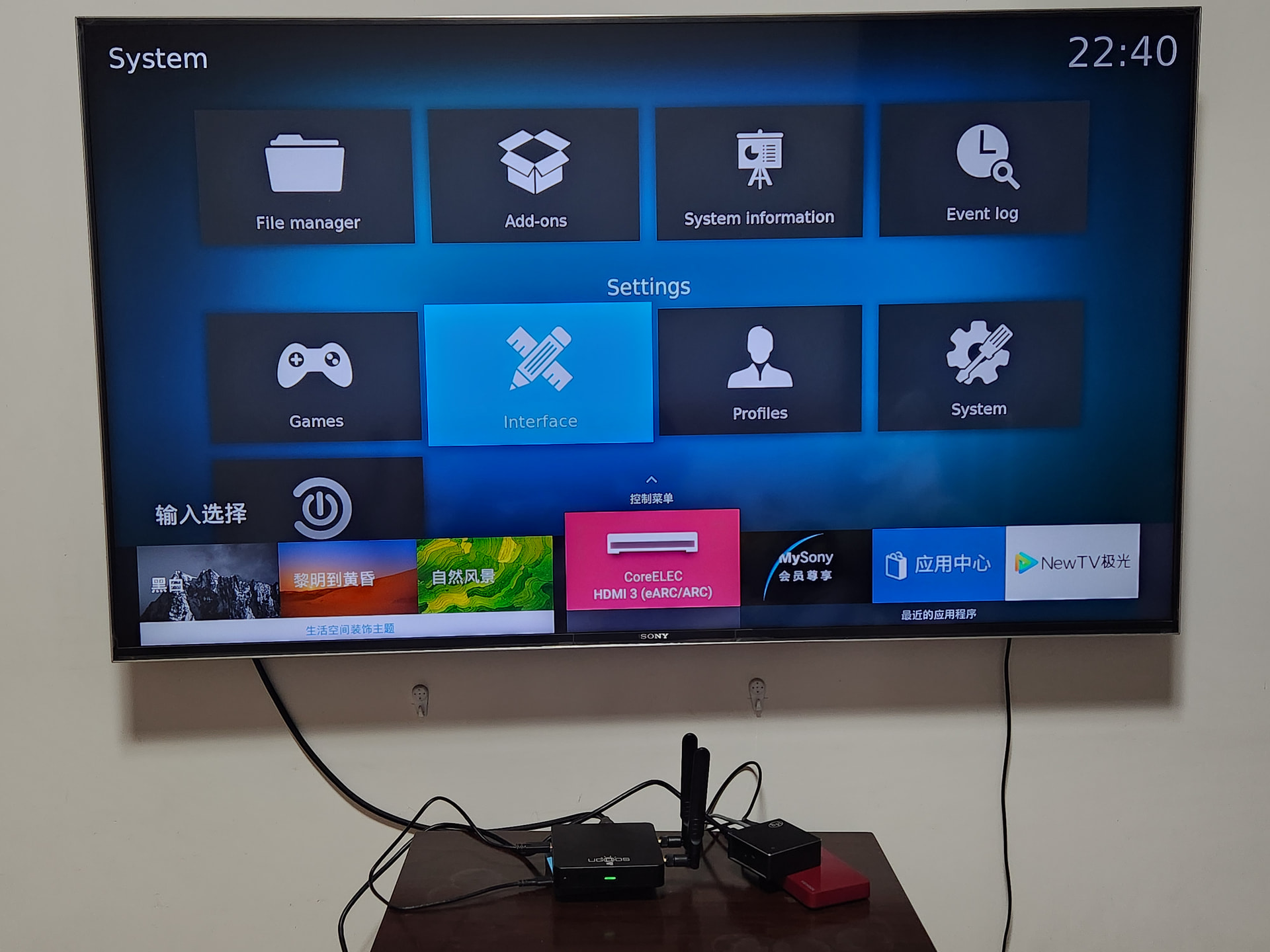

​@Portisch,
​Here is the evidence of normal playback on the same setup.
​The photos show that when I reboot into CoreELEC directly from the Android firmware, everything works perfectly (4K, HDR, correct colors).
​However, after a sleep cycle or a cold boot in CoreELEC, the screen turns green as shown before. This confirms that the hardware, cable, and Sony TV settings are all correct. The issue is specific to how the system handles video/output after a fresh boot or standby in the current build.
