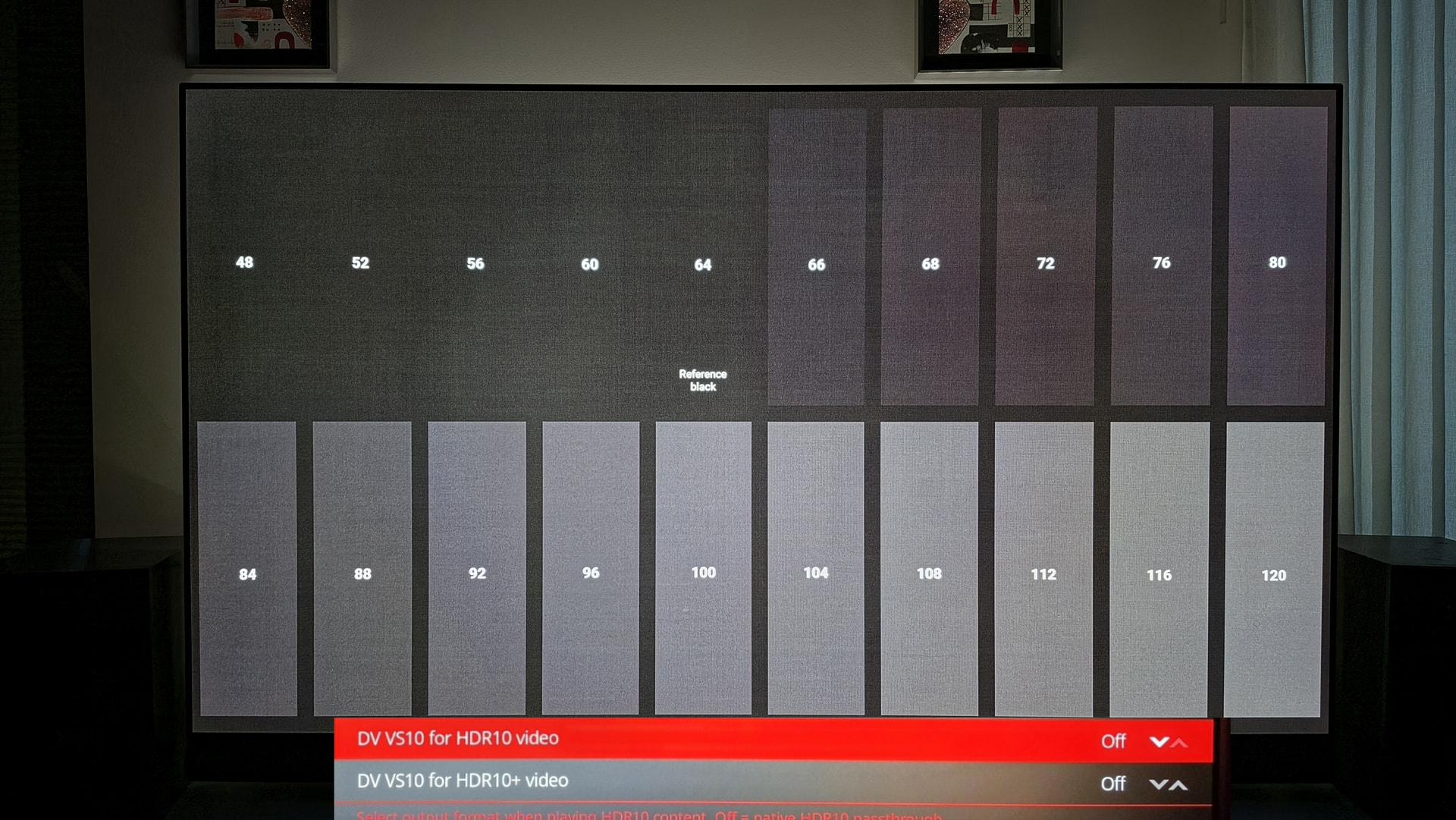

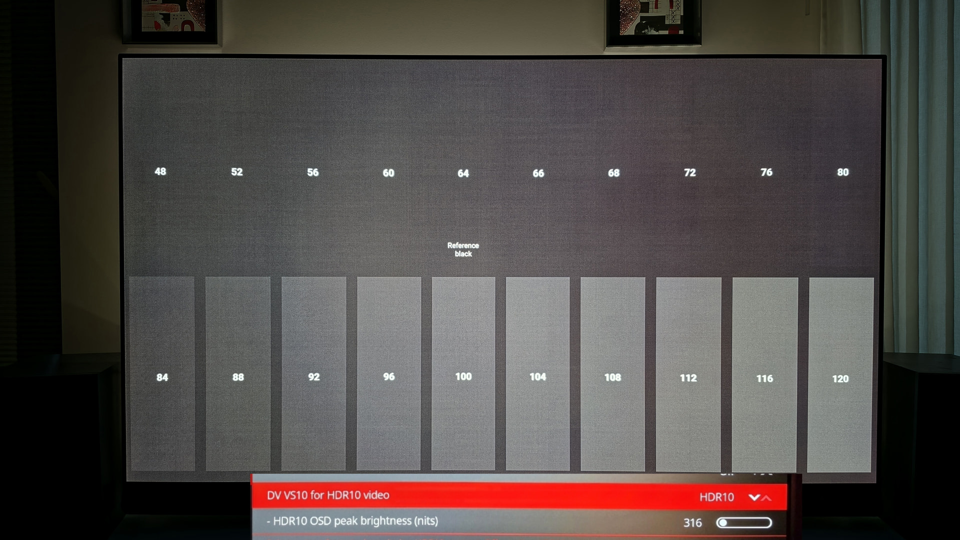

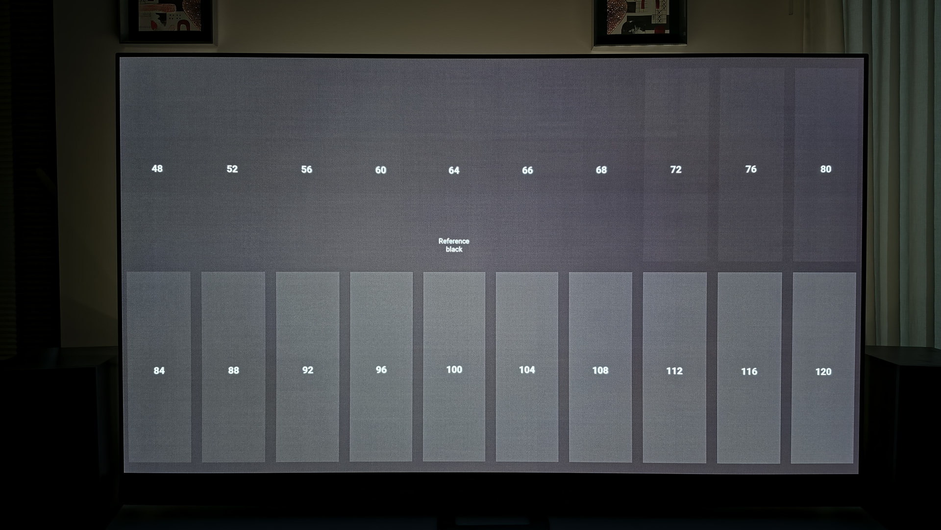

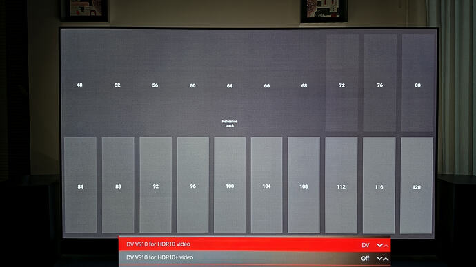

Tonemap HDR to DV setting has wrong black level causing black crush,hope it can get fixed one day.
I assume this images was not made on official build right?
No.
But here it is,tonemap hdr to Dolby vision official build bug,if that makes any difference..
Well the point is that the issue is present,probably this tonemap HDR to DV thing need some adjustments,otherwise it cuts deep blacks.
But I guess this is the last thing CE team will try to fix,since we would benefit using HDR>DV from like watching only some none existent MDL 4000 movies like Mad max:fury road.
99% HDR movies now are MDL 1000 and if it needs more nits the DV layer is already present.
Maybe your solution is to contact Dolby Vision direct as they are the author of the VS10 stuff?
I am sure they do know how to handle it correct.
