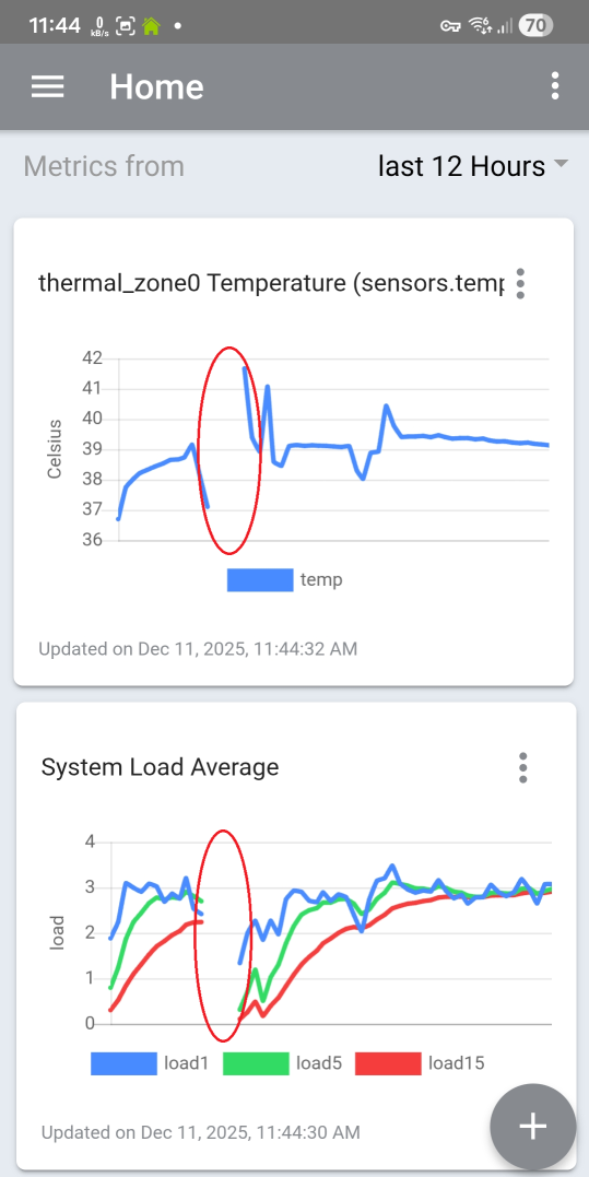

I have 2 Ugoos AM9 boxes. On one of them as you can read above I had a problem with CEC eventually fixed by flashing CoreELEC on new SD Card.
On the second device with CoreELEC I see it is rebooting at random times directly to Ugoos Android OS.
It happened again last night at 23:36 (this is the timestamp on kodi.old.log)
In kodi.log and kodi.old.log there is nothing… just new kodi.log is created when I reboot to CoreELEC using Reboot_to_CoreELEC_5.0.apk installed in Ugoos Android OS.
I can see this clearly on Netdata monitoring on my phone:
Is there a way to catch what causing this reboot?

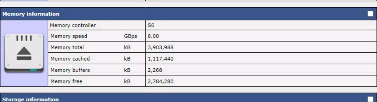

I am looking on the official Ugoos website, all I can find is the Ugoos AM9, where can I get details for the pro version ? Please
It appears in their 2025 catalog.
Everyone referring to this device, including Ugoos’ Telegram, is pulling their data from the catalog slide. The only other device there that is not in their normal site is the RockChip-based SK3.
It’s also unclear why the slide has LPDDR5 bolded together with Dolby Vision (but Dolby Atmos isn’t there, even though the chip should support it) - while in the spec itself the RAM is stated as 4GB LPDDR4X.
It doesn’t really matter what ddr number is stated,all it matters real world usage and the bandwidth,the am9 has total of 8gbps bandwith speed,while for a comparesment the everyone beloved nvidia shield 2019 has 6.80 gbps bandwidth speed(yes I kbow it is 6 gears old),so it could be ddr5 ddr10 or whatever,but only proper test could show real picture.
