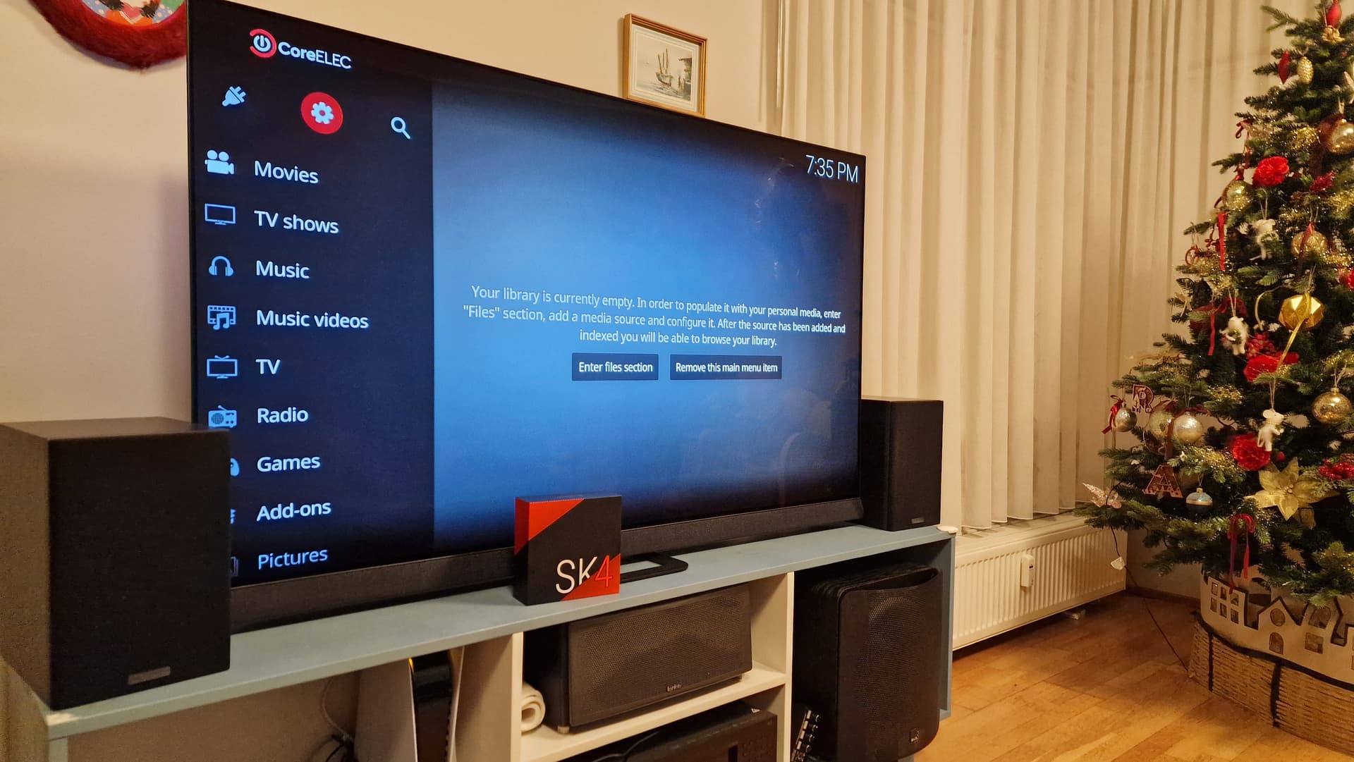

Ugoos SK4 system is up and running,but DV doesn’t work.

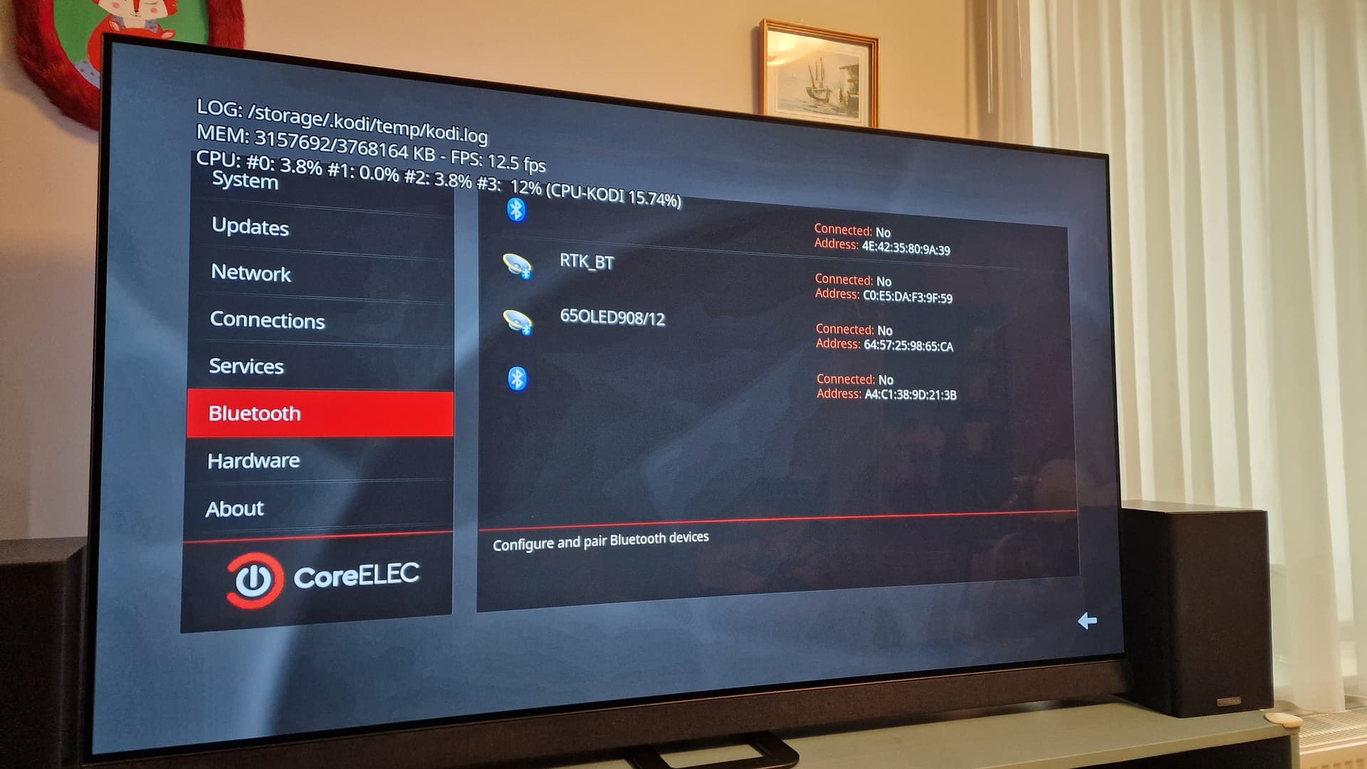

What about WiFi, BT, ethernet? Does it work? What else is not working.

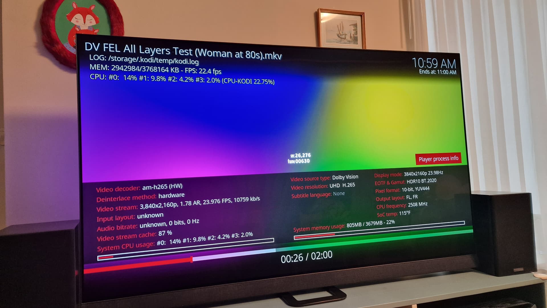

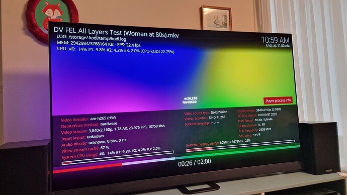

Hello sir,I played few DV files,DV Profile 7 displayed as HDR,DV Sails sample is displayed in wrong colours.
With x5mpro DTB coreelec boots,I tried other x5m dtb files and system didnt boot,ethernet doesn’t work,but wifi does.

Bluetooth works I guess.
DV Fel is displayed as HDR.

2025-11-28 10:45:41.798 T:2277 info : CAMLCodec::OpenDecoder Amlogic device does not support DV, DV is enabled by user, display does support DV, DV system is disabled
dvfellog.txt (62.5 KB)

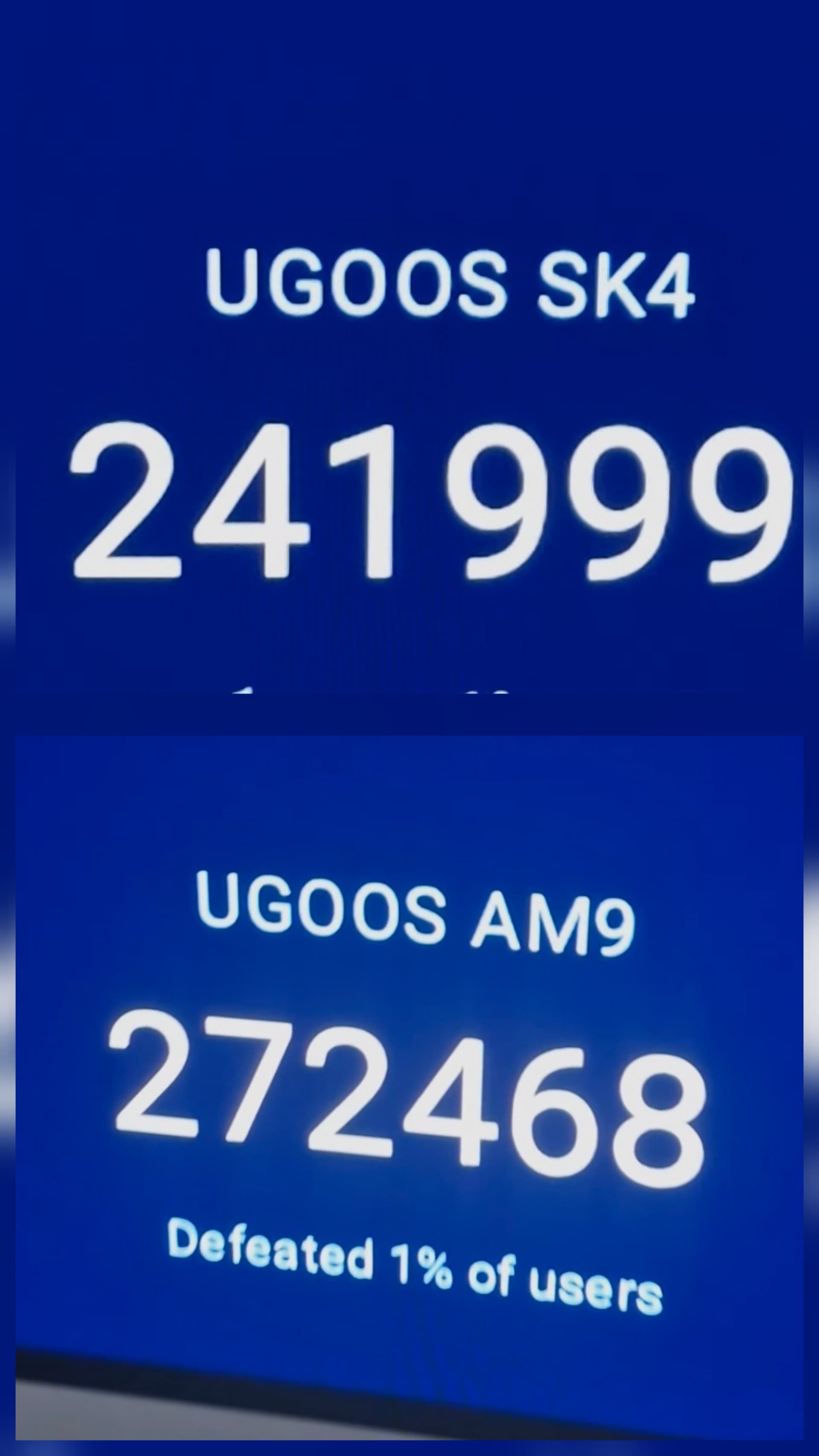

Ugoos SK4 Antutu 11.0.6 Benchmark:

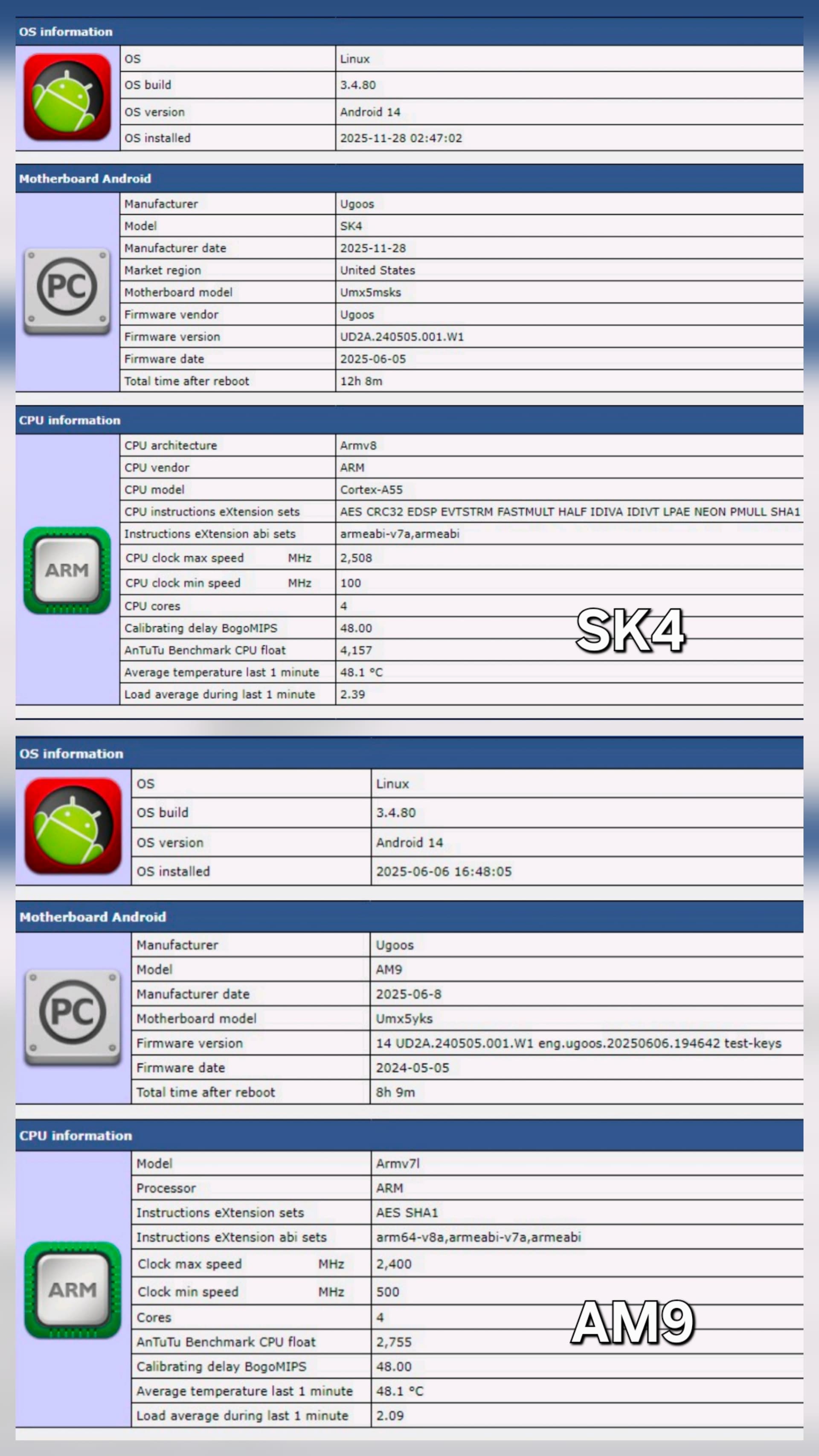

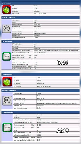

Hold up,wait a minute,I tested raw cpu performance from both devicec, SK4 has better cpu score than AM9,AM9 Has better GPU score and it utilizes 64bit android.
You can see test here if you’re interested:
Also one thing,that on first stock firmware,there were no option to set AM9 to max performace mode while test was done,but probably it can’t affect total score that much.
Also if you look at antutu score,the Am9 is not that far ahead from SK4.
Both are good devices,one has 64bit os,gigabit lan but no DV,other doesn’t have gigabit lan and only 32bit android,but has DV support.
