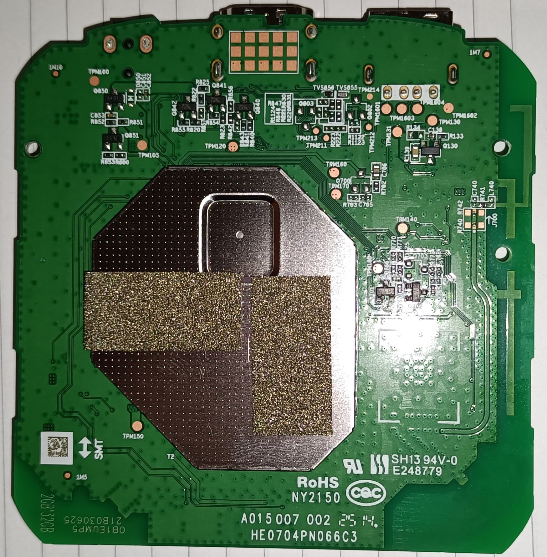

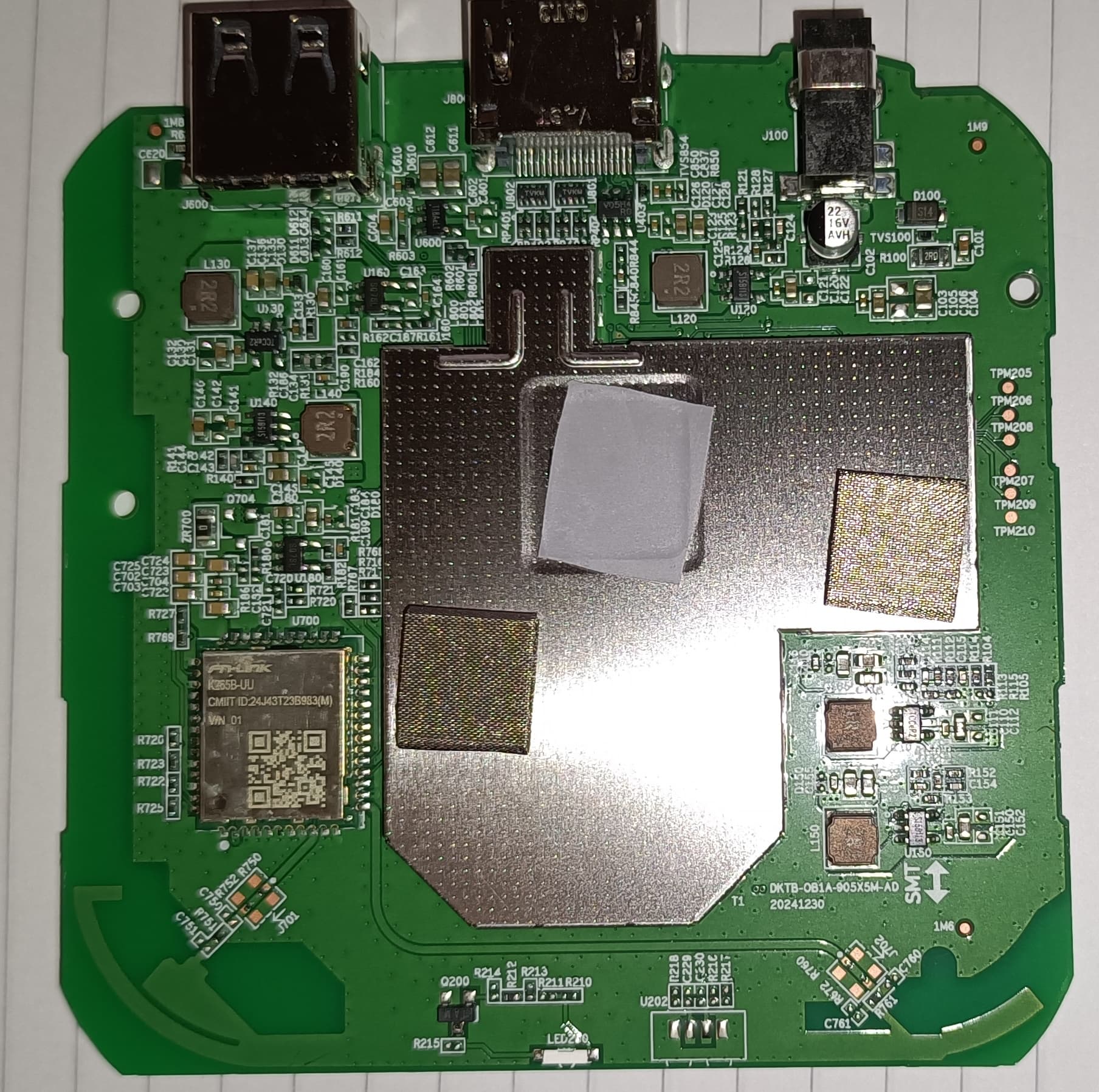

It just stuck at MI logo. Now is the question: open the device and check for a UART or just return to seller…
Are there pictures of the PCB exist? Is there a debug header at all?
I tried with the 20250920 build.
Could you try with this one and see if you get the same result ?
I’m also using the same dtb, it didn’t work with the first 64GB USB stick I tried, I also got stuck at the MI logo. However it worked with a different 32gb stick.
I tried two same 16GB and one 64GB, nothing.
How to open the cover. Can you make photo from the cover to see how it’s locked?
Damn, that’s crazy, I don’t understand why it doesn’t boot.
It’s just clips, put something thin into the seam and pry. I started at the back corner and worked my way around. Once open the board is fastened with 2 little screws and clips at the sides and front.
Any test what of the test points could be UART?
No idea, I was hoping they’d be labeled.
I’ve just tried again with a fresh install of the latest nightly and mine boots fine. Are you plugging the usb directly in to the box or through a hub? I did my first boot directly connect to the box and then used a hub after.
Test points are probably underneath the heat sync shield, the black plastic molding on both sides of pcb,
Can it be removed?
