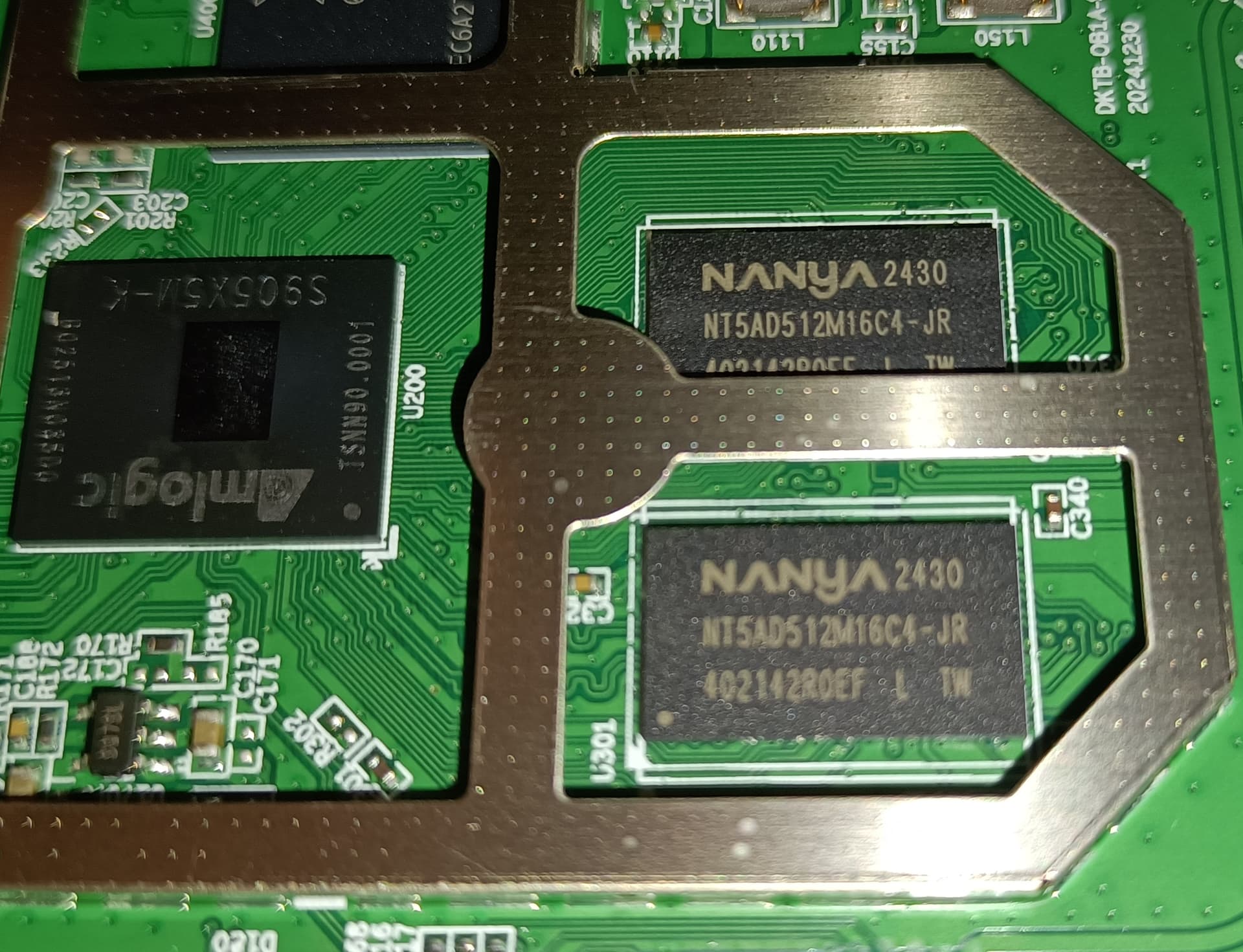

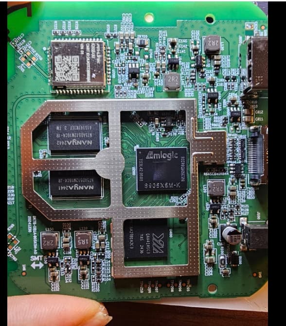

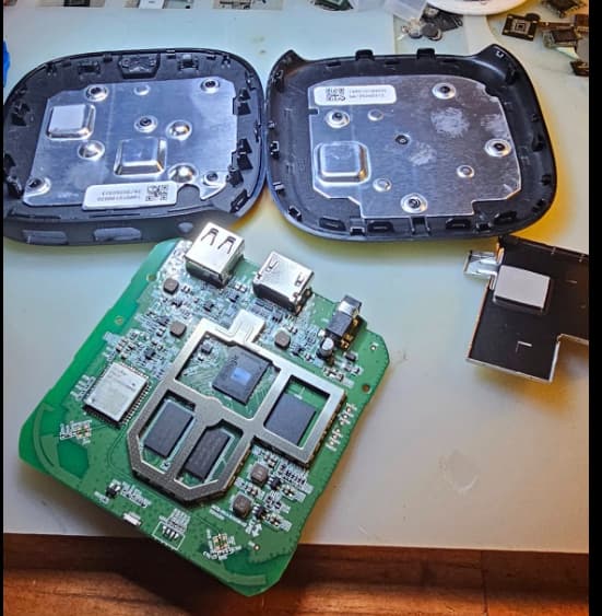

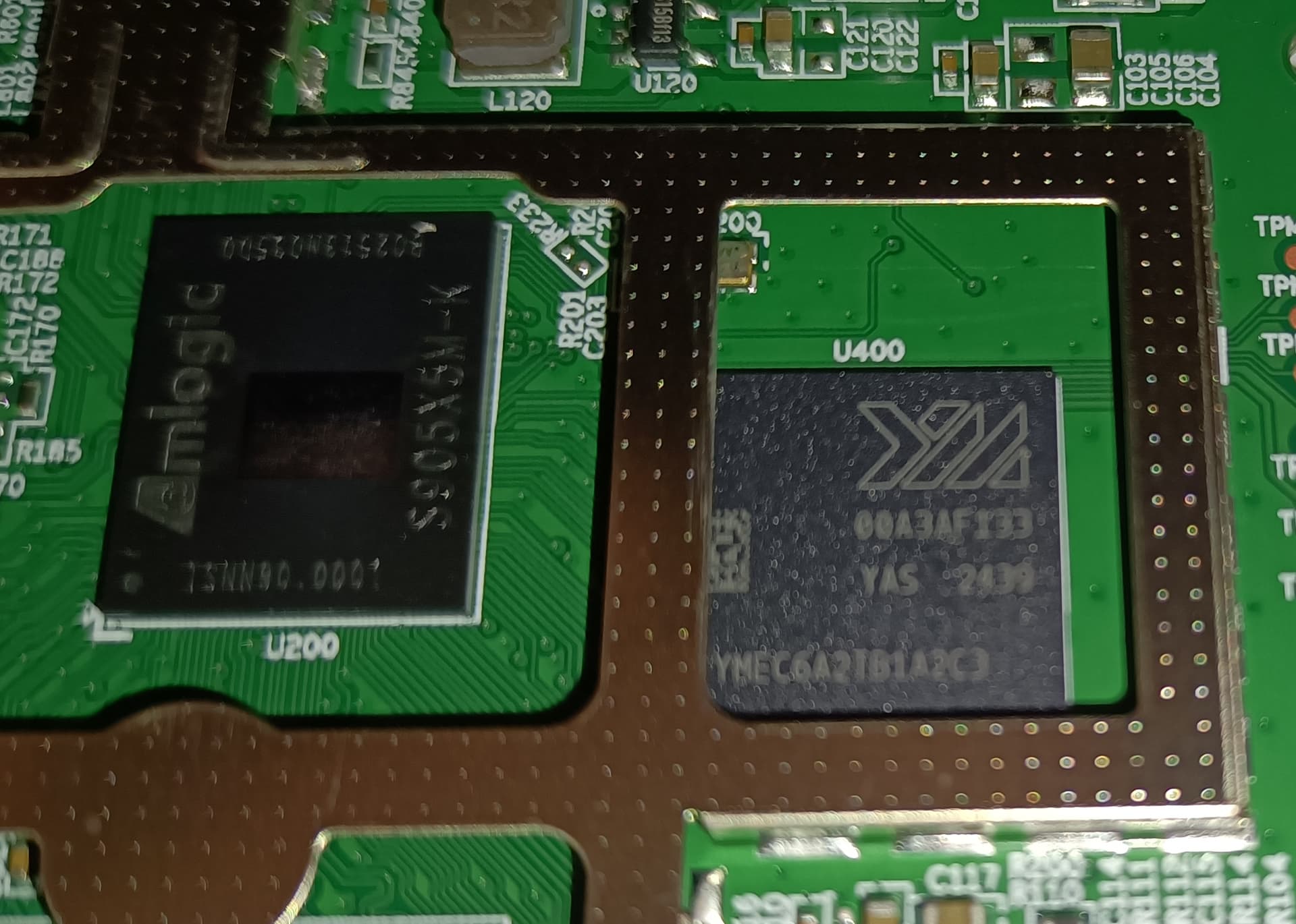

Than Xiaomi is the worst an bad case as example from China device manufacturers.
They sell multiple different hardware configurations under the same hood.
Use the autostart script from above to make a dump of the different configuration by using the default 2g DT.
Also make a detailed picture of the RAM you have onboard.
