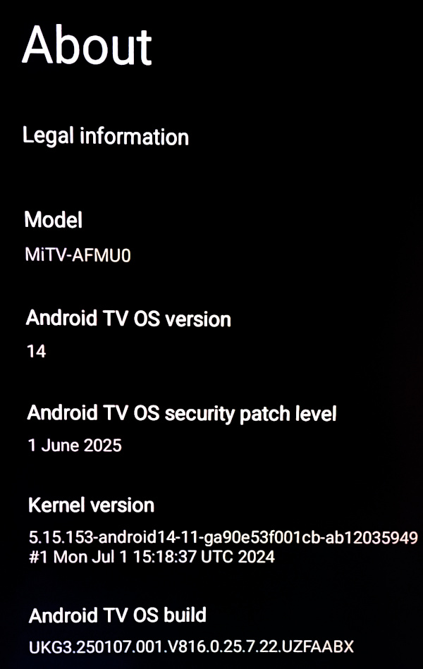

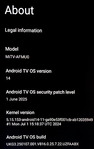

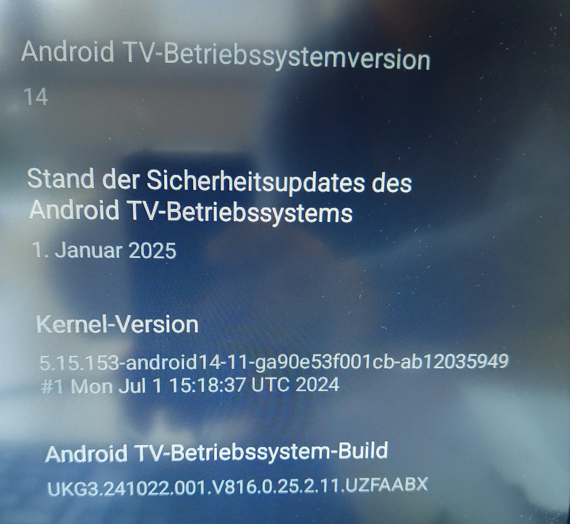

As for the the Android version, I have the exact same thing as @roidy, everything is the same as the screen.
Btw, are there things that need to be specifically tested ? Anything new ?
I saw your post @Portisch regarding WiFi, Bluetooth and DV so is there something you need us to test with this new dtb ?
Now I know the reason:
I have the build from 241022. The issue of booting is a bootloader item.
I try now the update available if it is 250107 build.
EDIT: yes, after the update the build is now 250107.001.V816.0.25.7.22 and CE just boot fine.

Ensure first the Android version is minimum: 250107.001.V816.0.25.7.22
Otherwise the device stuck on boot at the Mi logo.

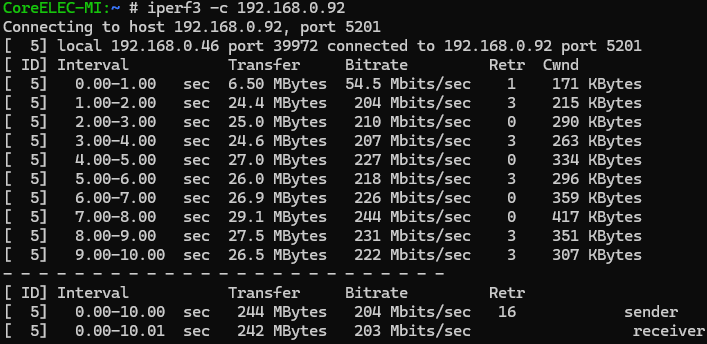

@Portisch, this is solid progress, thank you & any other CE dev working on this. Here are my findings… please LMK if I can provide any other insights:

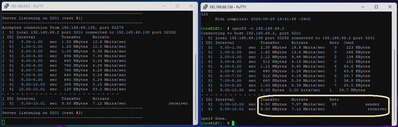

Wi-fi works, but speeds are abysmal. Getting around ~7Mbps-ish or so between my PC (10GbE network) & Synology NAS (also 10GbE) (below) vs. 340Mbps-ish on wired (using USB gigabit ethernet hub):

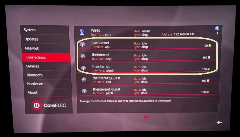

What’s strange, something I’ve never seen before, are 3 different Wi-Fi options for the same SSID?!.. I tried all 3, and speeds were the same ~7Mbps-ish, so switched back to ethernet for rest of testing:

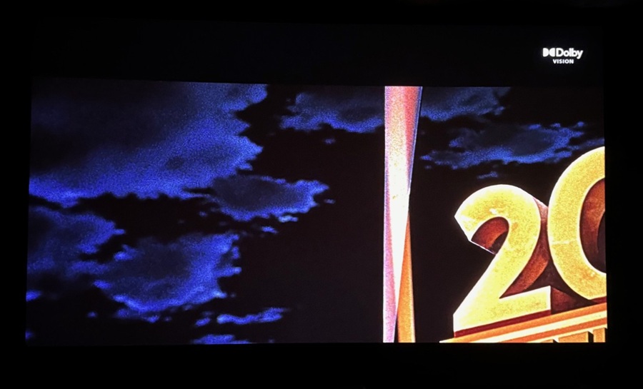

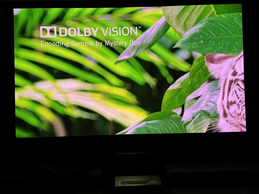

DV now works! All flavors (tested P5, P7 & P8). Yay! But, the display parameters are wrong. The picture is zoomed in, like so for all DV videos:

Maybe it’s Wifi station related. On one router I get about 500kBytes/s.
On another router I get >10MBytes/s.
Buy cheep, get what you bought…
Here is all working, no problem, no log…
Conculsion: Buy cheap and take what you get.
Finally about €60 for a DV capable device isn’t that bad.

Finally got a chance to try the new dtb and so far everything seems to be working really good.

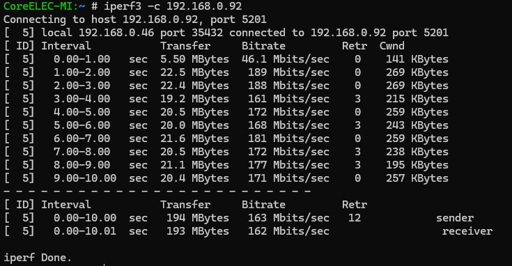

Wifi works fine:-

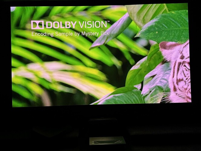

DV plays back perfectly, no zoom effect like @ht2tweak reported.
HDR10 and HDR10+ playback perfectly, no weird distortion like @ht2tweak reported.
