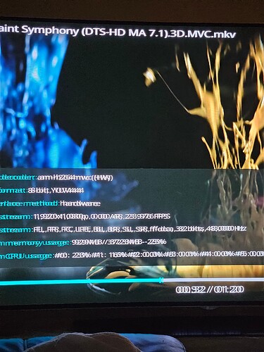

In my system both mkv and iso work with a problem.The problem is that the right eye image is much darker than the left eye image and therefore the 3d glasses do not engage it even if on the TV screen I can see the movie and the TV reports it is 3d.
Again any change in the settings do not cure this “strange” problem.

3D MKV MVC working. Sending the correct 3D signal to TV has some working to do. Sometimes have the feeling something is off. Mixed left and right eye or something else. I think it is because the TV detecting the signal wrong. Returning to 2d space after playback is not always successful.

First version gives blue screen when playing MKV MVC choosing ‘Preferred mode (same as movie)’ and plays normal if alternate mode - over / under selected. Playing ISO or ISO embedded in MKV container is working as above mentioned.
The first version works even when selecting Preferred mode (same as movie). All test mkvs work and ISO too, I download movies and check them. Rarely, but when the video starts, there is a lower black bar, if you stop and start the file again, then it’s normal. Only the Kodi 3D interface does not work. I haven’t checked the second one yet.
PS: The Kodi 3D interface also does not work on the second version.
