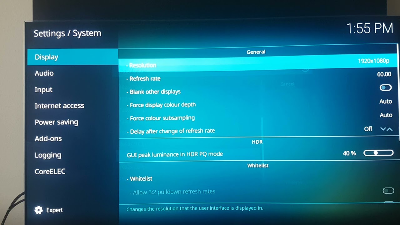

So, I tested with a base version CE19.5, updated to latest dev build from here.
I am getting the exact same result, whenever the resolution tries to switch, everything from the UI freezes. I made short videos to show whats happening. I guess, this is related to the Ugoos as it seems to work fine on other hardware?
First video shows the resolution change in Kodi itself, you can hear the UI sounds, but everything is frozen until it reverts back to 1920x1080p.

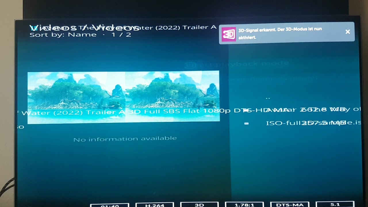

Second video shows what happens, when I start the Full SBS Sample, one more click to confirm the “preferred mode”, which you cannout really see due to the frozen UI. My TV detects, that something changes to 3D, but the UI is frozen on top. You can hear the sound, so the video is playing. You can then hear me navigating to the stop button blindly to stop the video and return to the (now completely messed up) UI. The messing up of the UI also happens in the current nightly for all non-MVC 3D-files, so thats not new :-).
As said previously, I am using a Ugoos AM6B+ (S922XJ) in combination with an LG E6 TV.
