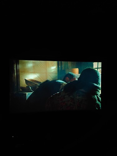

Hi! I have the same problem with am6b+ with the last devel update and since then ng nightly 7.26-7.29. All mvc be it mk3d or iso. Under sbs the gui and subtitles are good. I was going to write but still testing all the settings. I will test it today with CEC turned off completely. I have Himedia q10 pro and with it everything is fine in 3D. I have Optoma Projector and Denon x2600h amp, 2.1 HDMI cable, but with the added 1.4 HDMI cable I have the same problem. I also tried a clean install, now I have that too.
I don’t understand without showing the issue! All is fine on my screen.
Left eye
Right eye
Unfortunately, the CEC was not the problem. Thank you very much for addressing the problem. I thought that I was the only one with this problem, because I searched here on the forum, but could not find it. Should I also send a LOG?

The MVC 3D problem on am6b+ with log file. Optoma HD29Darbee projector and Denon avr-x2600h. I played the 3D Subs in 3D ISO Sample.iso. I don’t know what could be the problem if not for everyone, but I would be happy to be able to use it as a well working 3D player. I set the am6b+ settings based on this
https://paste.coreelec.org/CavalierPolicy
Left eye
right eye
Thank you very much!
