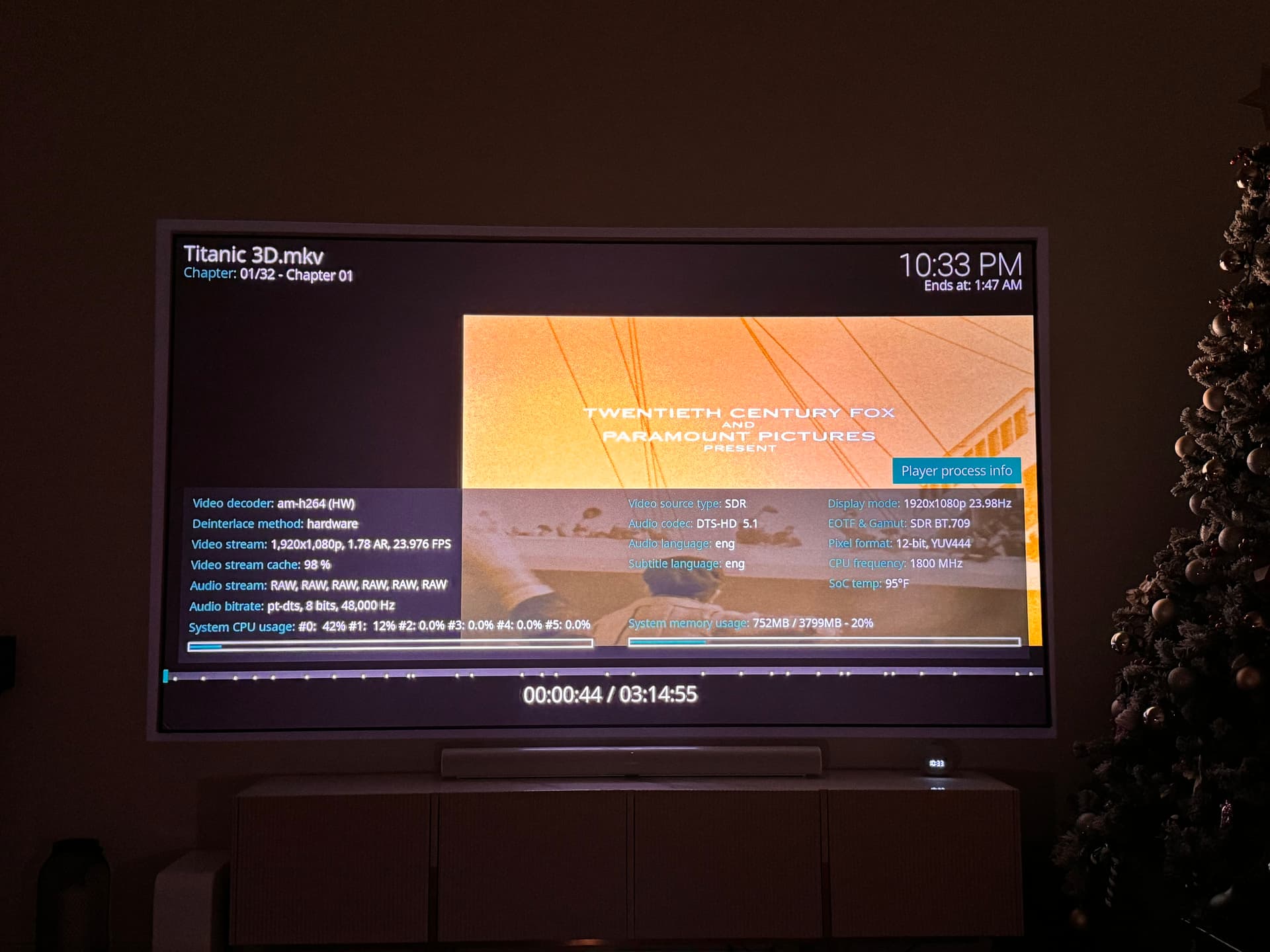

I am using the Ugoos AMB6+ and I tried patching the metadata to fix the “stereo_mode” as suggested. I am playing Titanic, Avatar and Passengers in 3D ripped using MakeMkv.
Running the CE 21.2-Omega. The stereo_mode is set to block_lr as default.
Device is not getting into 3D mode by default and I have to “enable” it from the 3D glasses icon at the bottom right.
Even after modifying the metadata, it doesn’t automatically go into the 3D mode. If I pause the movie, enable 3D and exit and play again, then I see something which looks like a 3D image, but no idea what it is trying to do. Also Makemkv is reading the MVC as 1920x1080 instead of 3480x1080 as suggested somewhere in the thread above, not sure if it applies to the format I have.

You do not need to “fix” your metadata when stereo_mode is already set.
CE-NG and CE-NE does not fully support 3D.
Use CE22-NO.
When then it still does not work make kodi log with video component enabled and share a part of video as sample. Without a log and more info I just guess your TV does not support 3D at all…

However, you are mixing very different issues together. MVC has nothing to do with anything side-by-side, right_left, left_right and so on. 1920x1080 is also correct for MVC and should be like that.
MVC is block_lr or block_rl only in the metadata, nothing else. For your movies, they should all be block_lr afaik. From a glance at the metadata, it doesn’t look like this is actually a 3D-file at first glance? Are you sure you extracted the MVC-stream in MakeMKV, as it is deselected by default? Usually, with 3D MVC, the first line reads something like “Stereo High@L4.1 / High@L4.1” and not just h264 (high). Can you share a sample, like 1min, of the file?

Did you get any 3D file (especially MVC) to work so far? I can provide a sample which definitely works, if you need one or download some from here: https://kodi.wiki/view/Samples#3D_Formats Number 5 is a 3D MVC MKV.
For the log from Portisch: For SBS-files (3840x1080 for Full SBS or 1920x1080 for Half SBS) it is supposed to be “only” h264 and nothing else. Think of it this way: side-by-side or top-and-bottom are already “prepared” two-eye frames in a completely normal video stream. Other than the metadata (and the weird-ish resolution for FSBS) nothing shows, that it is 3D. The player does not need to process the picture and just sends it as is (with a flag, that it is 3d, if the player knows about it → thats why metadata is so import for these files, as the player can only guess, that it could be 3D for FSBS/FTAB from the resolution, which is not 100% sure).
MVC is completely different, it consists out of the picture for one eye only and a second special video stream (which you cannot see or watch), which contains the difference between this single eye and the other eye. The player (in this case the Ugoos) creates the second eye on the fly, assembles a picture in a special format (neiter SBS nor TAB) and sends it to the TV. So there is picture processing, done on a hardware level and the player knows for sure, that it is 3D from the file itself and it should be no issue, sending the so called frame packed picture to a 3D TV.
