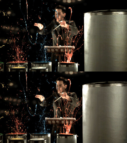

This test image do open now 1080p instead 1080i, no idea if it works.

The image in 3D MVC output mode is output as 3d-FP, it is not a over/under
The signal resolution should be output as 19202160.
The am6 on HDMI gives a 1920
2160 signal, but the image itself is not displayed.
