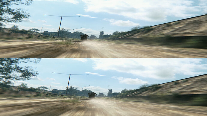

this is the wrong output option, we output in 3d Top/bottom mode, the resolution is cropped and instead of 1920 by 2160 has 960 by 1080, i.e. half of the screen is cropped.
The real 3d MVC is 1920 by 2160.
testing 3D-full-MVC.mkv. its output as 1920-1080, NO 3d FLAG
The real 3d MVC is 1920 by 2205. That’s right, this is exactly what we need to achieve in real mode of packaging Full HD 3D frames. This will be as technically correct as possible.

Here a new test image CoreELEC-Amlogic-ng.arm-21.1-Omega_devel_20240603162829.tar.
The display mode switching is reworked, MKV only and only MKV with valid stereo mode meta tag.
OK, on new version we have image, but wrong (DTS paint video).
