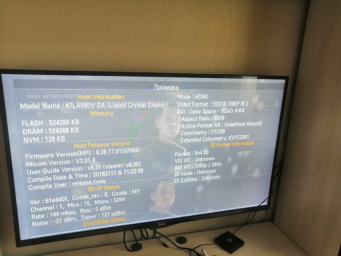

The TV is not 3D-LG. There is also another LG 3D and Samsung 3D for testing. If it is important that hardware 3D is enabled in the menu, after playing or stopping, you need to re-enable it in the 3D settings. At 4 seconds there is an incomplete frame, the music stand is not visible. Attaching photo.

Tested on lg c6 beelink gs king x, with settings-same as movies, it engages hardware stereotypic but does not trigger 3D
Tested on AM6B Plus. Hardware 3D is not recognized by the TV, I checked it in the “over/under” mode - then the TV switches to 3D mode when selecting Kodi in the video settings. The file DTS Paint Symphony (DTS-HD MA 7.1).3D.MVC.mkv when selecting “over/under” at the beginning of playback goes into 3D, the TV recognizes 3D, the music stand is visible at 4 seconds. Not Frame Packing mode.
