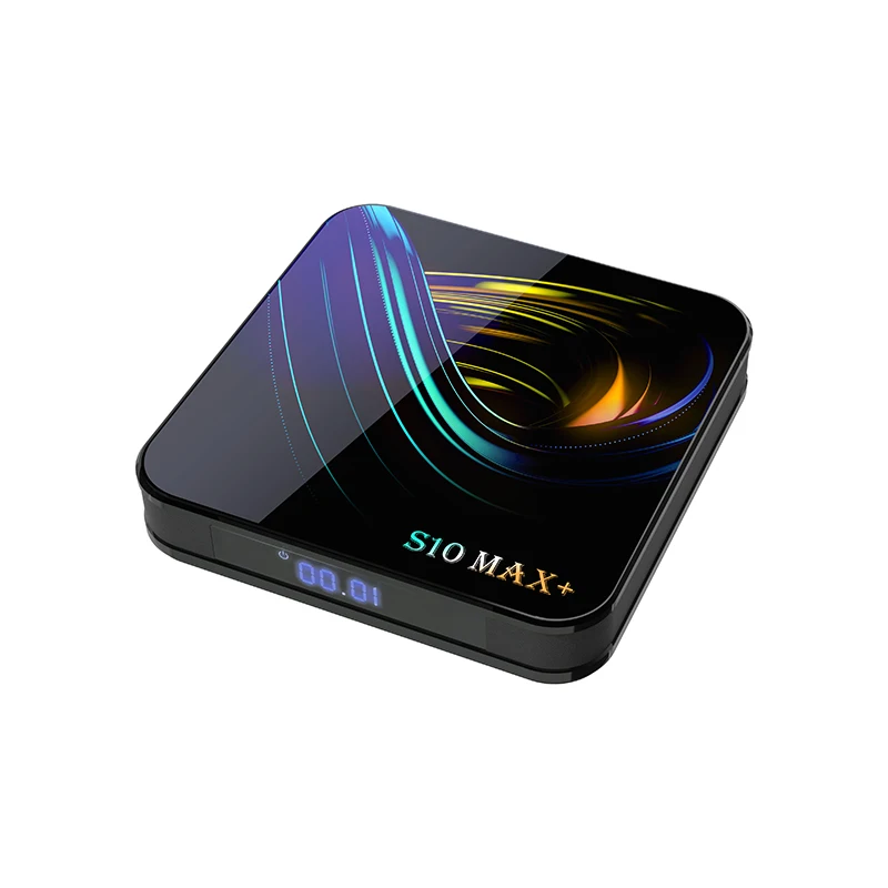

In case somebody is interested. I installed CE 9.2.0 on a S10 MAX+ box (S905X3 4GB/32GB, €35)
As expected, ethernet/wifi/bt is not working, but it does when using an external USB/eth adapter.
Besides that, all main CE functions are working just fine.
Is hardware decoding used during playback?? (usually press ‘o’ during playback and see if Hardware Decoding is active - apologies if you already knew this :grinning:)
If so, I’ll be getting one of these. (May I ask where you got it from?)
Yes, HW decoding. Tried FHD h264 and 4k h265 stream.
I bought it at AliExpress, but apparently it’s gone now…
Here it is still listed:
