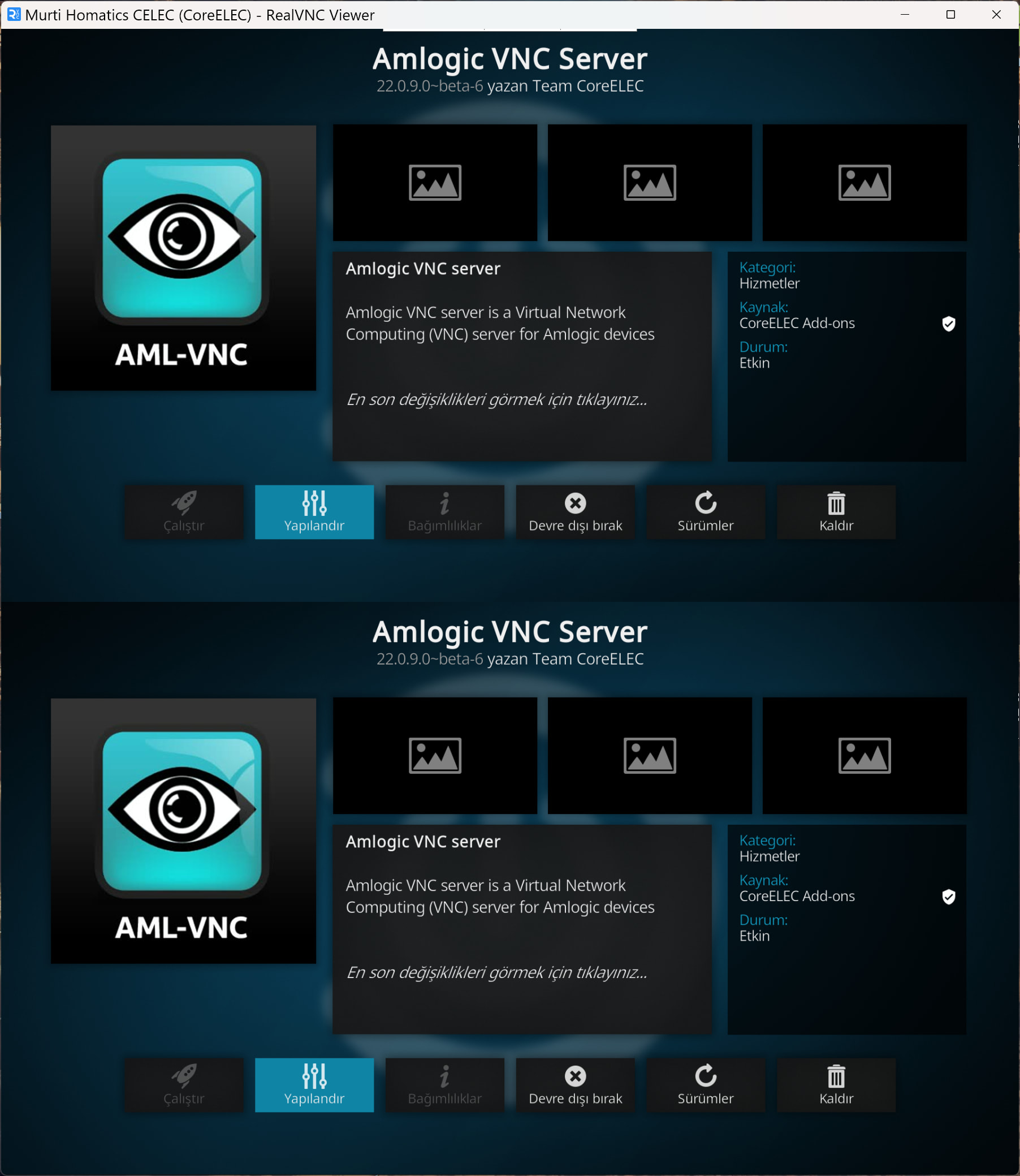

I updated to the latest version, it works great, but it appears as a duplicate on my PC. How can I fix this?
Sincerely…
What GUI resolution? Disabled gui scaling?
Greetings,
Resolution: 1080p/50Hz.
GUI Scaling: Off.
Sincerely…
I would need the server log, which might confirm my suspicion that the device is using double buffering. To extract the log, you need to run this under SSH:
journalctl | grep aml-vnc
In addition, it would be important to know what SoC you have in your box, because as I noticed, the DRM parameters can be different.
But the easiest way is to send a link generated by pastekodi, it will contain all the necessary information.
Edit:
In the meantime, I realized that this was probably the same as what @Portisch experienced earlier, so I took a different approach to correct the problem.
Please try this new version to see if it solves the problem: https://dtech.hu/aml-vnc/service.aml-vnc-22.0.9.0~beta-9_20260314.zip
Whether it solves the problem or not, I would definitely like a log. Thanks.
https://paste.coreelec.org/GentlyPills

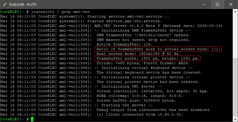

Unfortunately, the log you sent is quite incomplete, the entire journal section is missing. Also, you didn’t say whether beta 9 fixed the problem or not, which is important information in itself.
So if possible, please let’s run another round on this topic. I don’t need the entire log, but you should definitely make sure that aml-vnc is running.
I suggest the following command to extract the minimum information needed:
The two really important lines for me would be these:
However, it turned out from your log that the affected SoC is S905X4, because you are using sc2_s905x4_sei_smb_280.dtb. Unfortunately, I don’t have one, only a box with S905X5M, and this bug does not exist on it.
If my fix actually works in beta 9, I would expect these two lines:
Ratio of framebuffer size to actual screen size: 2:1.
Framebuffer width: 1920 px, height: 1080 px.
Thanks for your cooperation.

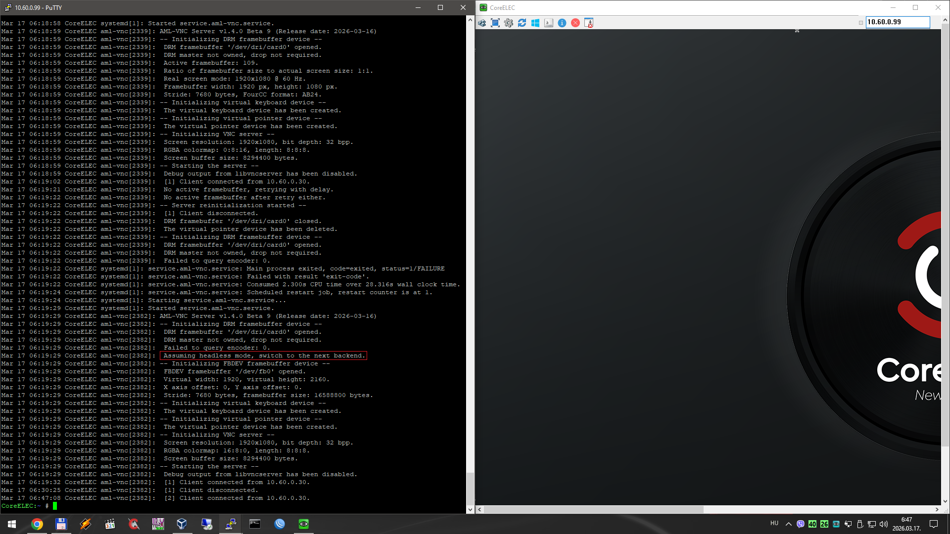

The previous bug report for the C5 has now become clear to me. In the case of S905X5M, /dev/fb0 also exists, but it does show splash screen instead of the live screen. This way, the VNC server will permanently show the wrong framebuffer, but this is not the server’s fault, unfortunately the system does not handle this option.
I consider this to be a deficiency, so steps may need to be taken to solve this issue.
The new beta is ready for testing: https://dtech.hu/aml-vnc/service.aml-vnc-22.0.9.0~beta-9_20260316.zip
Probably, headless mode will now work fine on devices before S905X5M. The VNC server basically uses the DRM framebuffer primarily, the reason being that it is faster to read, so the interface produced by the server is also more responsive, because the FPS is higher.
However, if this is not available, because it is running in headless mode, then it will fallback to fbdev (after the server service is restarted), and it will remain there permanently, because now it does not change backend even during the runtime reinit.
