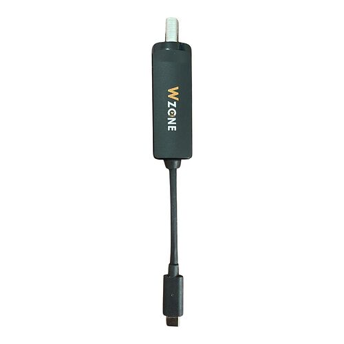

Hello dear @smp,
A friend of mine bought this tuner with TYPE-C input to use in Homatics boxes, but he can only use it on the ATV side. Since there is no driver on the CE side, it cannot be used.
On the CE side, the lsusb command does not list the product. I think the TYPE-C product is onboard.
What can we do for that tuner?
Is it possible to run it?
Best regards…
WhatsApp Image 2024-01-03 at 13.08.51

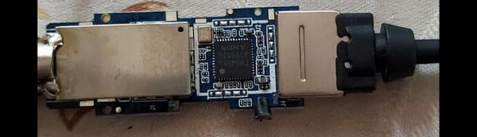

Homatics tuner can be used only in Android.
In includes
cxd2856 demodulator
r836 tuner     DVB-T/T2/C, ISDB-T/C
av2018 tuner   DVB-S/S2
and communicates with I2C I think.
thx @smp. The drivers are now in the new nightly 20240103.
Thanks to the whole team.

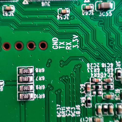

How can I connect a terminal via UART ?

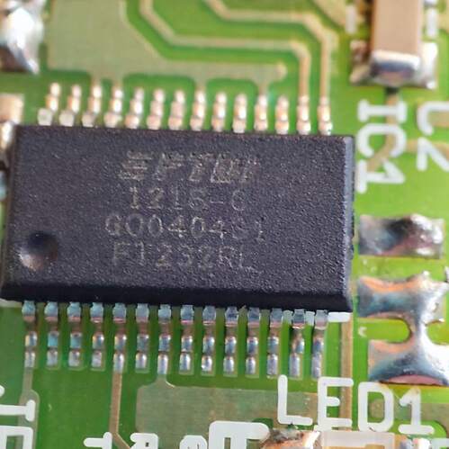

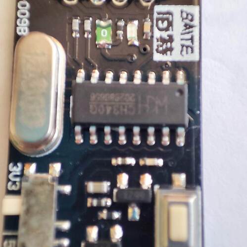

You need to have a usb uart converter. I have two:
and
Needs to be disassembled box and find the uart connector.
Mine looks like this:
Connect gnd to gnd, tx to rx and rx to tx with a cable.
In Windows, use e.g. putty, set the serial and speed to 115200.
Find out what com the converter is installed on.
Start the box.
The startup log should be displayed.
Unfortunately, I have illegible characters like these:
������~Ӵ��*�:�B�F���J^[�jZ�{�v��Wה*����n�{z���n���Wה�����n�{Z��Sn���Wה�����n�{{��Sv:�Wה����J���B^���J���B^���J���W�W��V��V�B��������~��G�J�~�{Z���v��Wה����J��{z���n���Wה����Z�~�{Z��Sn���Wה����Z��{z��S��Wה����Z���z_�JK�Zb[�j��w�����W�J�����Z���B����Z���W�W��V��_"���������~��G�Z��{���v��Wה����Z�������G���Z�G�����[����Zb[�j���wnޝ������Ά����Zb[�j���SSnޝ��ה��Ά����Z_[�j��ownޝ��ה��Ά����ZJ��W�W��V��V_��n�{���wnޮ��ה��Ά�������������~��G�Z��{��SSnޮ��ה��Ά����J�~�{Z���v��Wה���"��{Z���n���Wה����J�[�j���Sn�޸Wה���"Jn�{Z��Sv��wה����Jƍ�_��gJƍ�^�{[^�["cK��C)v�J^��W�W��V��V_"�����Z���~��G�J�Vwwv��V��J_��W�W��V��V_"���������~ӴܴJ�����J���W�W��V��V_����������~��G�Z��{
           ���Sה�������ZJ���������Z������"ʞ��K��׍"����QNK�Z��kZ枭ׄ���K�Fw�K����Z_��W�W��V��V_"���������~��G�Z���W�W��V��V_����������~��G�J���W�W��V��V�BJ�*�����~ҴܴJb���"J�����J�jǎ_�ߏ�����*^��JG��J���W�W��V��V�B���������~ҴܴJ�厬��v�bB掬�J�·Jc����v_��
Terminating...
Thanks for using picocom

Thx for such log!
For next UART log add in config.ini:
coreelec='loglevel=7 nopkmute'
Then it will record everything over UART like dmesg.
