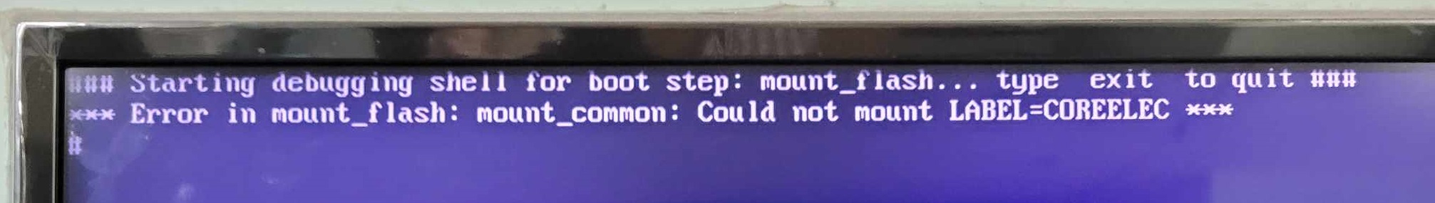

Yes, USB device
I have this mount problem with a 64 GB SD card but not with a 32 GB SD card.
If I free the USB ports on the device, there is no mount problem with a 64 GB SD card.
If I want to run it through the USB port it boots without any problems.
I am currently running it with a 32 GB SD card without any problems.
My device: GT KİNG II
Same issue with latest build , sd card in a usb holder. Similar s905x3 4gb
