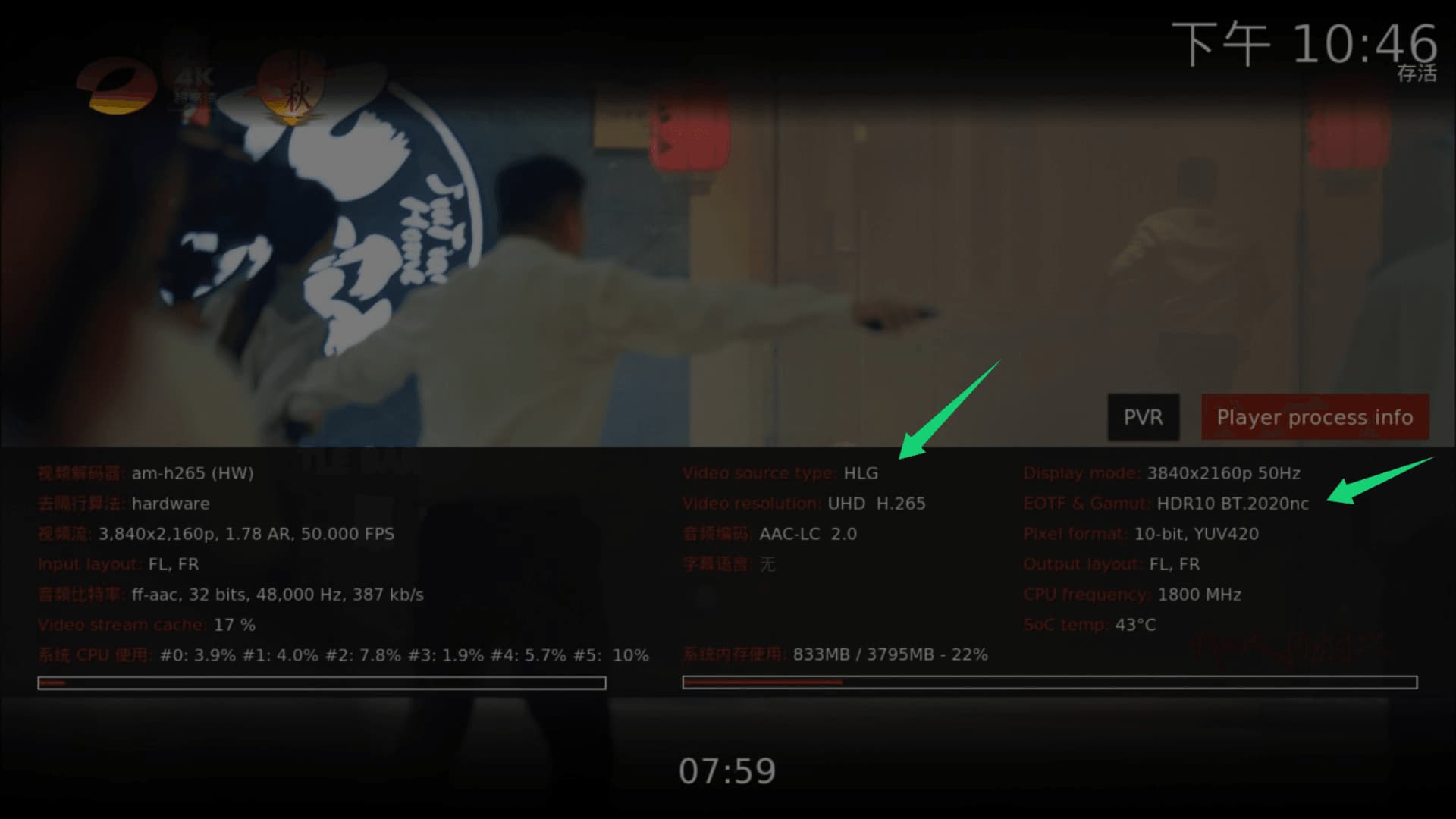

For the Chinese version of HLG (HDRvivid tone mapping uses HLG), CE outputs the wrong signal format, causing the TV to display the wrong color tone.
sample:http192.168.100.113587 10-06 22-42-35.ts

With next nightly the sample will play with HLG.
