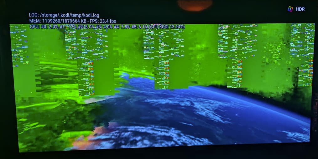

Sorry it took a while. Here is a log taken right after playing a HDR movie for a few seconds (Odroid N2), and the screen is very messed up. Using current NO build (20250930);
https://paste.coreelec.org/DevelopsFinesse
I start playing the movie here;
2025-10-02 00:30:51.455 T:921 debug : OnPlayMedia /var/media/CORSAIR/Jurassic.World.Rebirth.2025.HDR.2160p
HDR seems broken as of 20250913 build onwards.
UPDATE: 1080p HDR plays fine, but 4K HDR gives the problems shown here.
Yes ,same here on N2, Back to NO build (20250910), no this issues
Still working OK for me , I’m now on 20251002
Tox3 S905x4
Seems not about HDR, 1080P OK, 4K NG.
