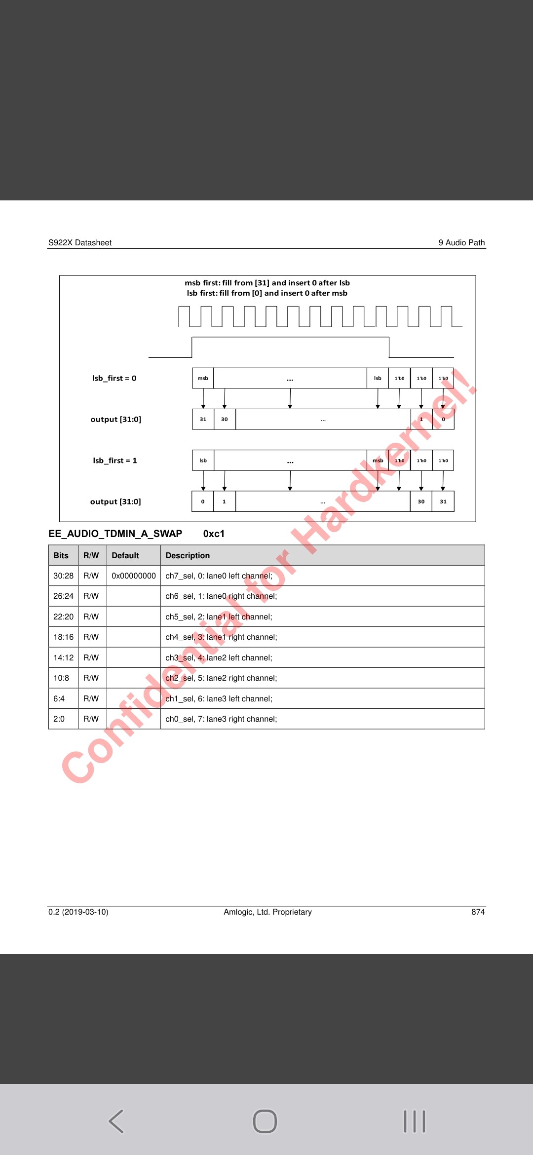

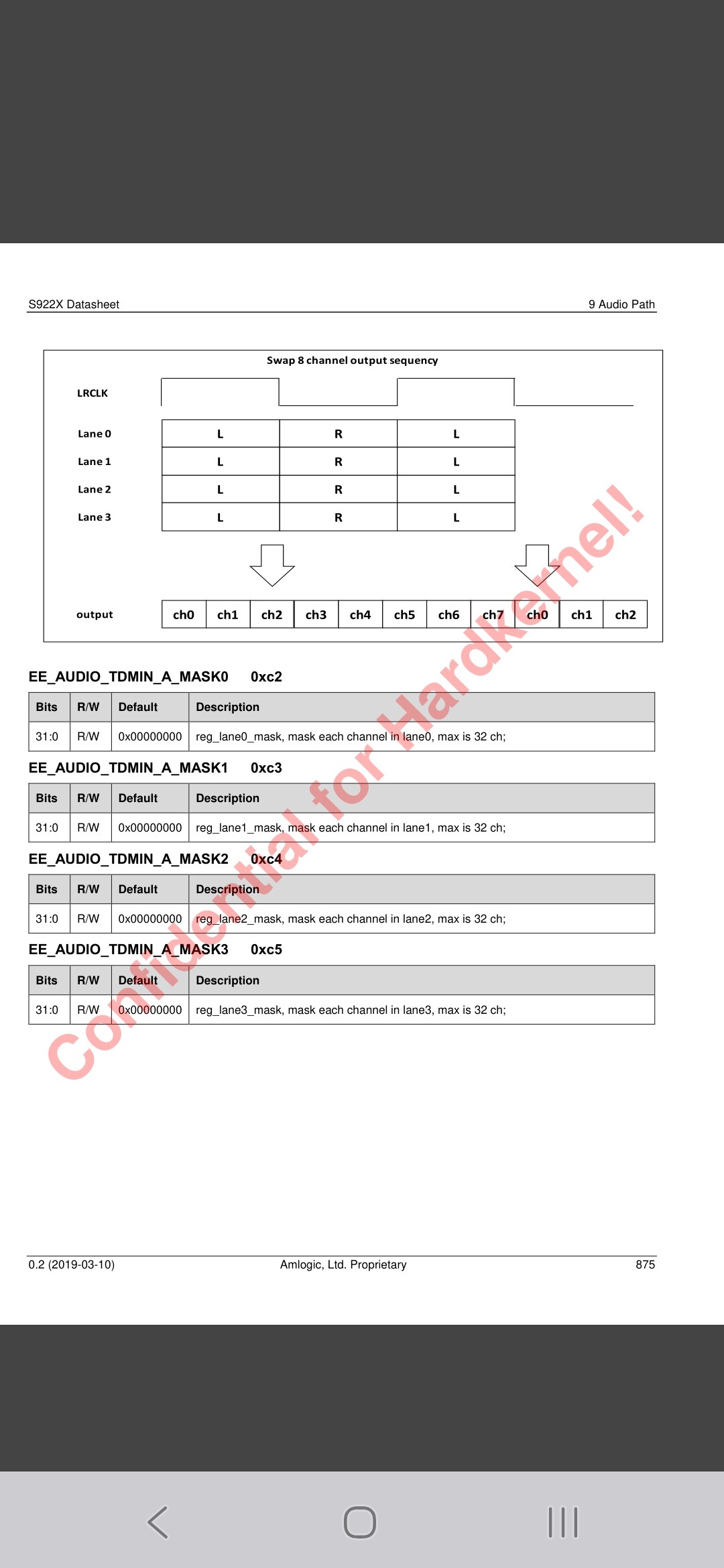

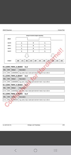

I found something maybe useful to amlogic settings to more channels audio in datasheet of s922x.
