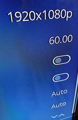

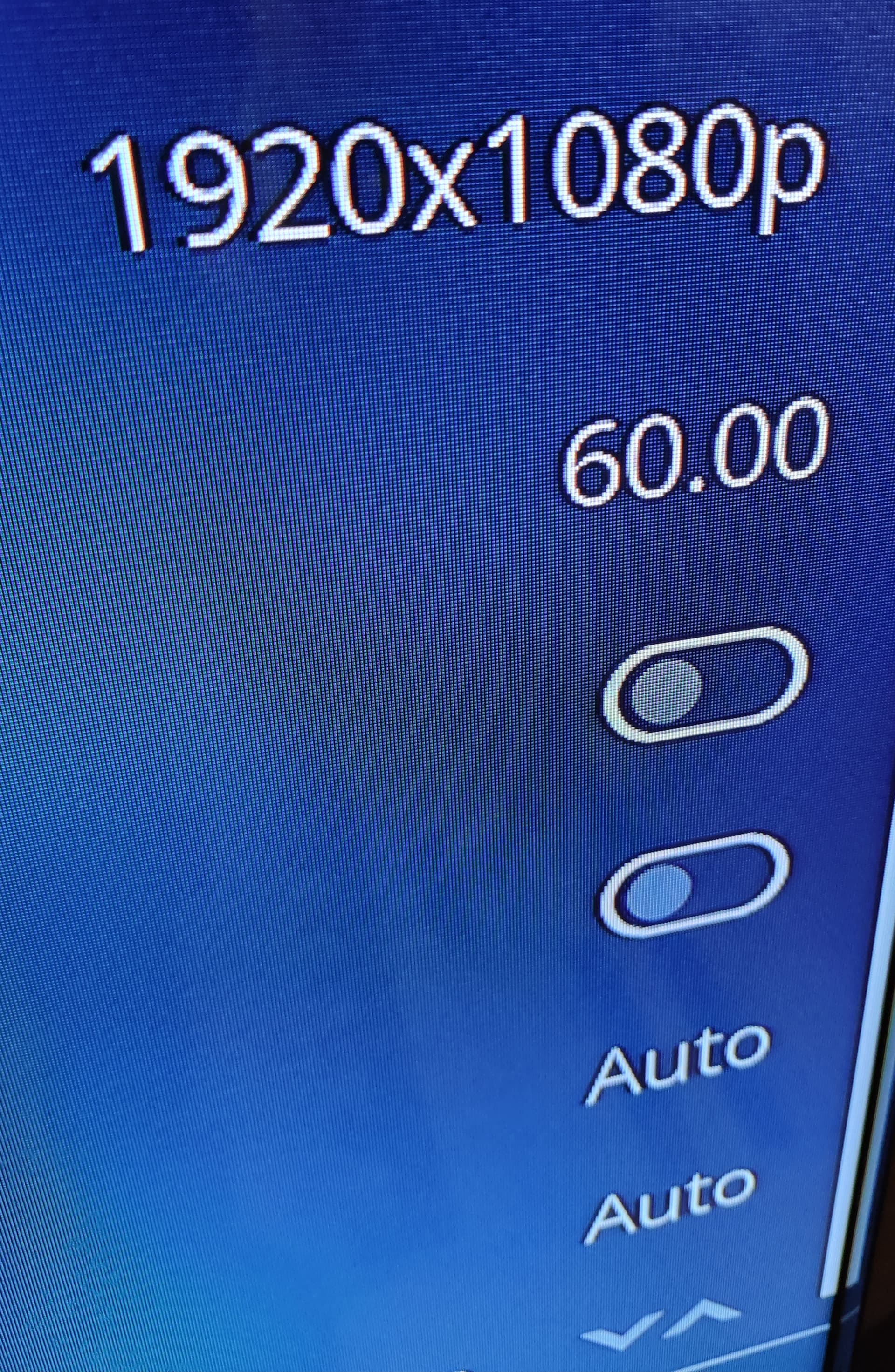

I noticed a problem with the box.
I set the screen resolution and refresh rate to 1080p@50Hz.
I turn off the box from the menu with the “shutdown” menu, and then it switches to 60Hz immediately. It hasn’t done this before.
If it hasn’t switched here (it’s happened before), then at some other time.
Another option.
I turn on the box with the remote control. I wait 1 minute.
Then I turn on the TV.
And the TV switches to 60Hz…and it also says 60Hz in the CE menu.
This has never happened under CE19.
How can I help you find the error, if any?
Thank you.

I used the box in the past hour at 50Hz.
No problem.
Restarted the box with the shutdown menu with remote…box restarted and again, CE changed the Hz to 60 in the menu by itself.
Another observation:
I turned it off with remote controller the box, it changed again to 60 Hz, and then turned it off.

Then I upgraded to 20251025.
Menu set to 1080p@50
Reboot
Menu set to 60Hz by itself.
