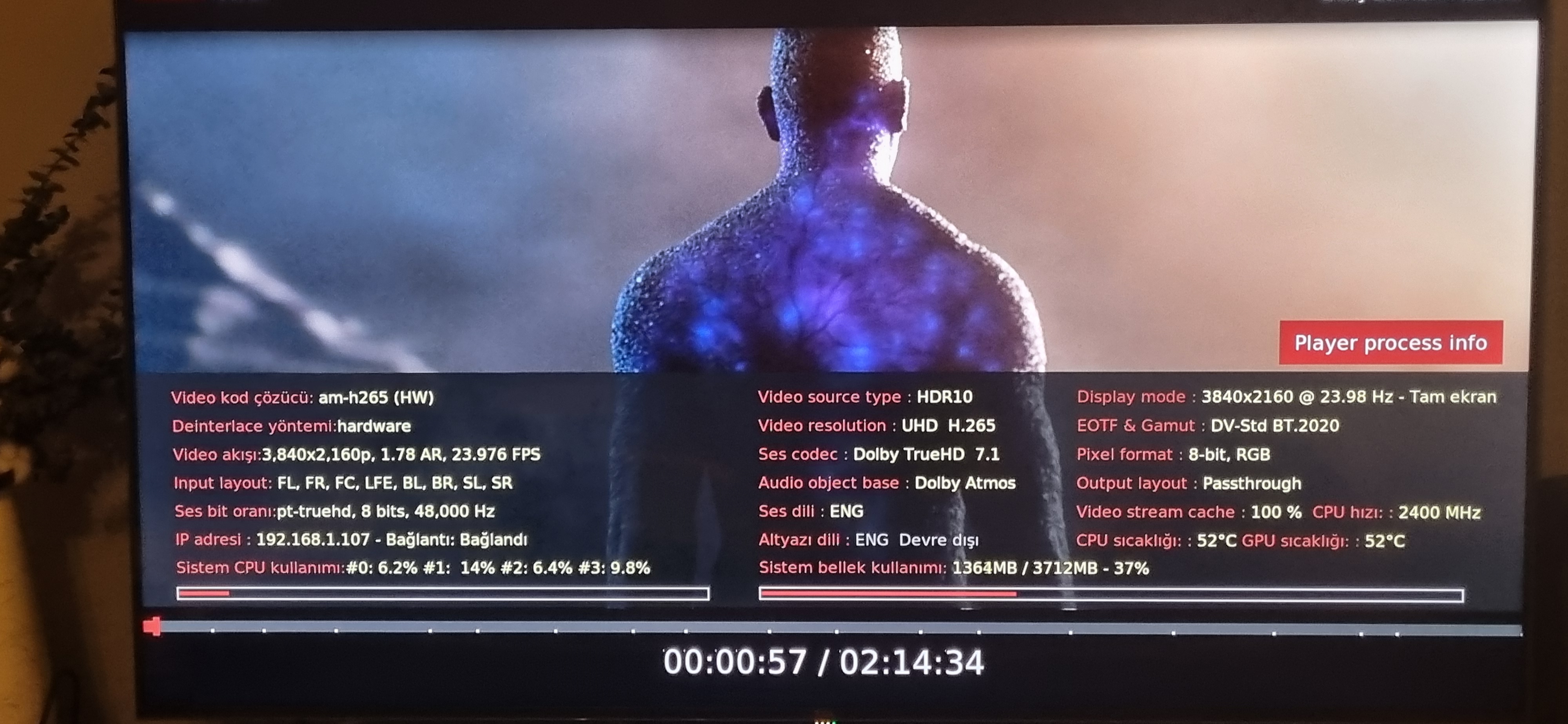

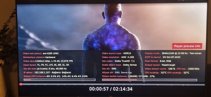

I’m playing it from a USB stick. The Blu-ray video information is as shown in the screenshot. It won’t play at all on the AM8. On the AM9 Pro, it plays after the device or Kodi has been restarted.

And how do you play it? Just select it and when dialog appear select to play main title?
Looks all good on AM9.
I’m choosing Heading 4
Your sample plays fine on AM8 box, but I do it from nfs source.
May be USB stick is not enough for this video? Try to play it from some network source.
The same USB stick plays without any issues on other King Pro II, X96 M300 and Ugoos SK1 devices.
Based on what you’ve said, I suspect there might be a USB port issue with the AM8 as well.
I think I’ll need to perform a clean install for the AM8 and AM9 Pro
The “skin.estuary.modv2” interface and its plugins causing the issue in AM8.
Once the plugins required for the interface to work had been removed, the video began to play.
After a clean installation of AM9 Pro, Blu-ray videos are played using the ‘skin.estuary.modv2’ interface

I tried a few videos, but the device reset itself whilst playing one of them.
After the reset, the same video played without any problems.
kodi.old.log
kodi.old.log (138.7 KB)
