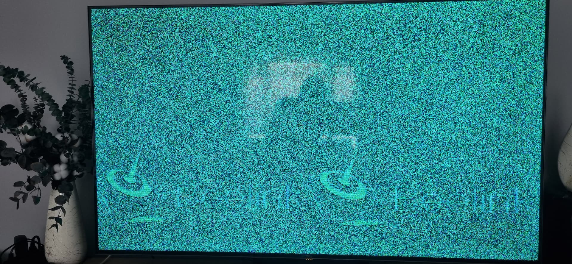

On the latest nightly build 20250304 my box with s905x2 processor goes into bootloop on vendor screen. Until version 20250302 it worked properly using g12a_s905x2_2g.dtb .

My Gt King ii is working with this dtb file.Old dtb file.
t7_a311d2_beelink_gt_king_ii.dtb (45.5 KB)
My Gt King ii does not work with this dtb file.New dtb file
t7_a311d2_beelink_gt_king_ii.dtb (46.8 KB)
Opening with the new dtb stays here.
Booting from ”SD? 4 or 8GB RAM?
”SD card 64 GB
Ram 8 GB
Try this with newest nightly:
t7_a311d2_beelink_gt_king_ii_8g.dtb (104.3 KB)
Thanks, it works now
