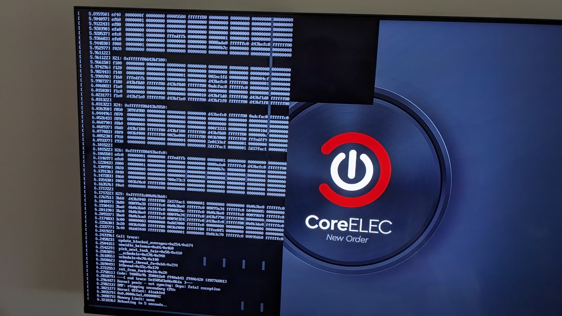

I forgot to mention that when I first boot from the uSD I get the partition making normal stuff and it ends with rebooting in ?? secs.
Itās only from that point it fails to boot and I get the screen in my previous post. I donāt even get the Hardkernel logo.
Just thought I would make that clear.
At this point, if you cold reboot (power cycle) is it the same or you first see Hardkernel logo?
Yes, first see the Hardkernel logo.
One thing I did notice is the text in the Call Trace is always slightly different.
I did an install of Nexus Stable onto the same uSD and all is good. So the issue is related to -no.
