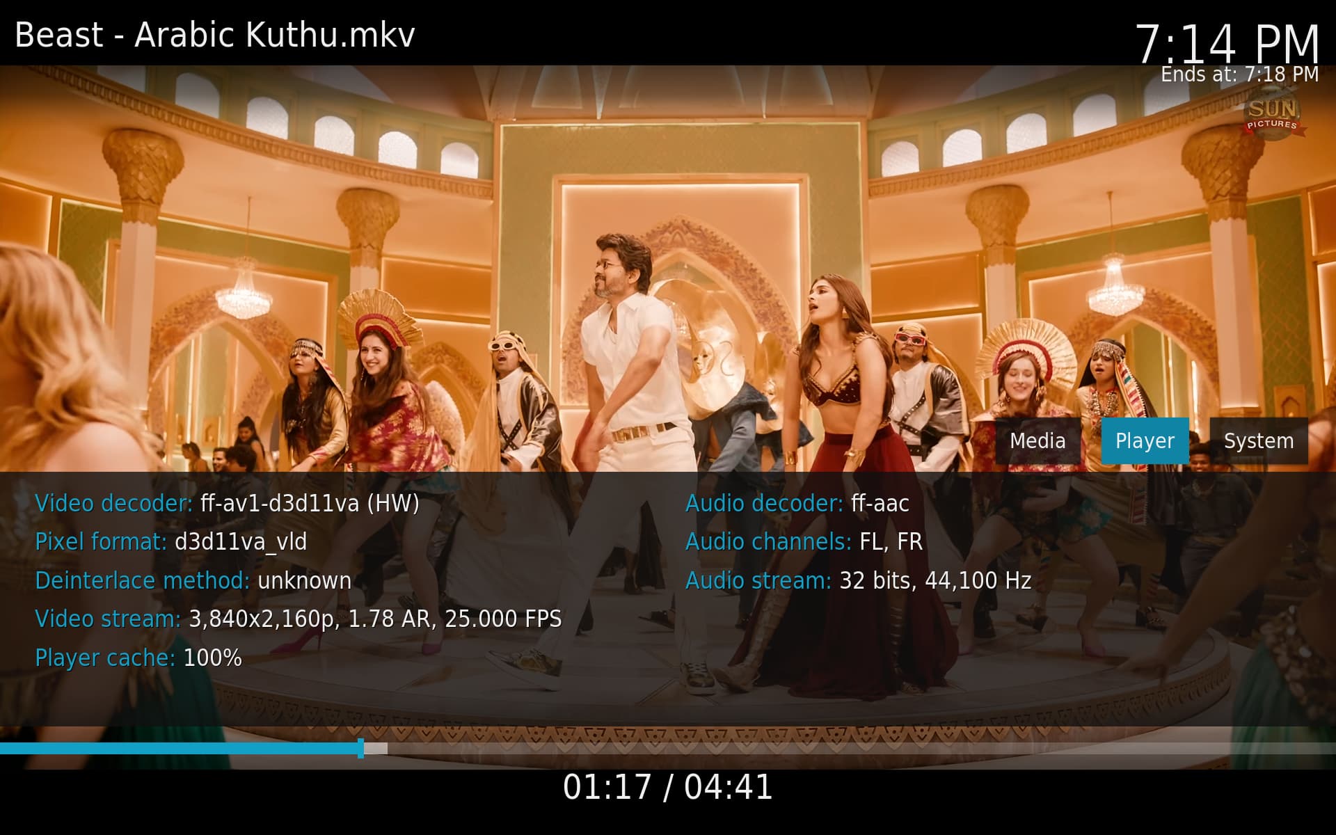

@Portisch Thanks for the latest nightly and my S905X4 (SC2) based box (X96max+ ultra) is able to play videos again. However the AV1 encoded video playback is still not working. The file below plays fine on my WIndows Kodi but not on CE NO running on S905X4 (SC2), The audio track plays fine but the video track is stuck on the first frame.
Can you please check if it plays on your end
https://www.mediafire.com/file/hrjx7oegra4il2v/Beast_-_Arabic_Kuthu.mkv/file
Here is the screenshot where it works on Windows Kodi

The file plays perfectly fine on my S905X4 box (Dune Homatics R 4K Plus) using 0319 and last nights 0322.
