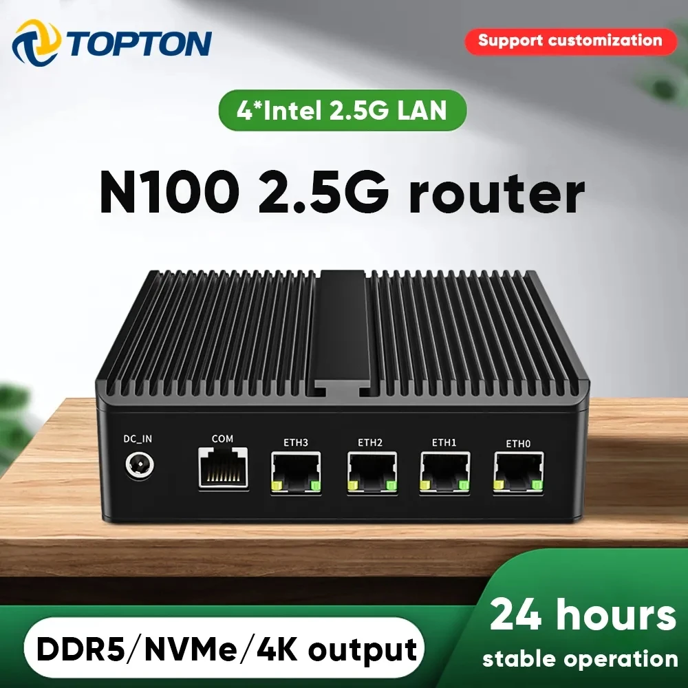

I would try this fanless option for a media player.
It seems that all the major drawbacks associated with x64 processors have been addressed with the new N100 series processors - and they are now nearly as good power wise as the ARM competition. Hardware decoding is on a par and you dont have to rely on the quality of the vendor kernel to get it working.
Decent enough ones start at around €200.00 which for a long term prospect is acceptable. It seems that they struggle a bit on 4K at high frequencies but thats an issue i wont have to face for a few years yet.
I like the look of these bad boys;
This thread is named “Best device for Coreelec …” which Intel devices clearly doesn’t work. So please stop such discussion or open new thread.
