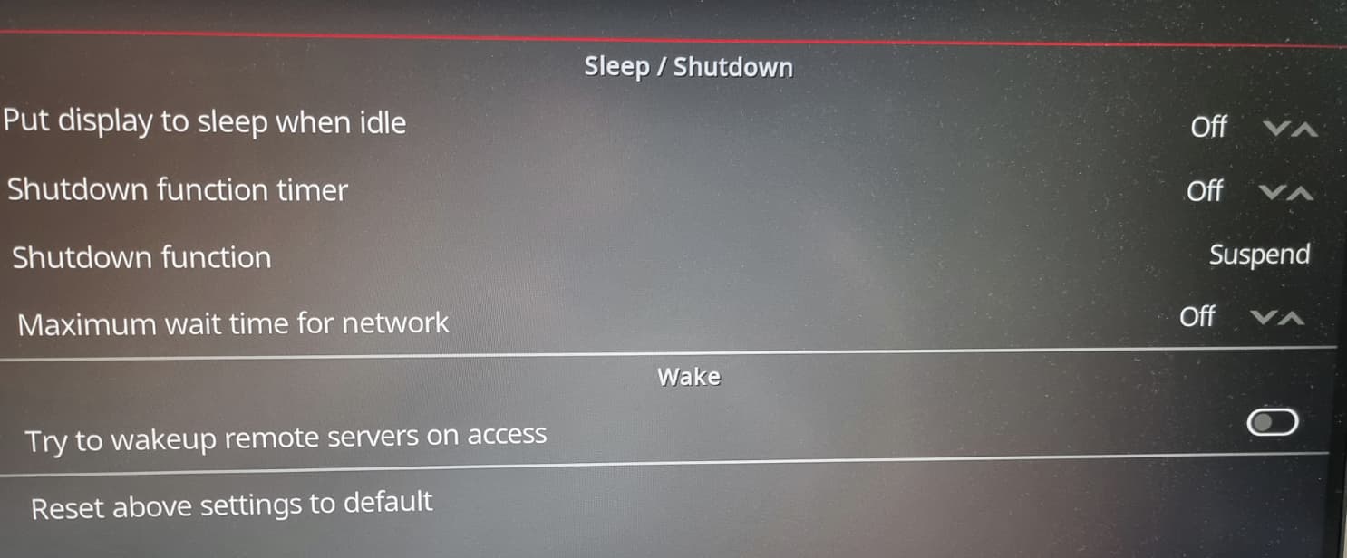

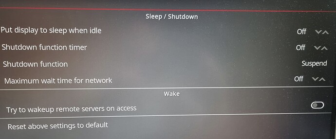

Tx, that looks a cool feature and Iāve enabled it. Though the Minix seems to go to sleep despite all the power saving options being disabled. Please let me know if thereās an issue connecting or when finished.
You will need to keep the device online when we should take a lookā¦
Sure, but I donāt know how to keep it online. It had a red LED this morning vs blue for on.
What other settings could be making it go to sleep?
It was short online but itās gone again. Broken internet?

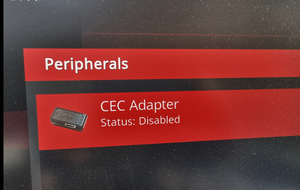

The TV can send the device by CEC to power off. Disable CEC input in kodi.
Just gone to sleep again, itās back on now and Ive disabled the CEC input device (took a bit of tracking down).
Have a look in the box settings WITHOUT CE card or usb inserted.
Bah, itās gone to sleep again. Not sure what you mean by the above. Thereās no USB inserted and I donāt know what a CE card is, nor does Google. Do you mean remove the HDMI cable?

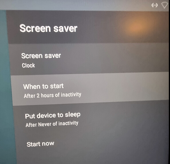

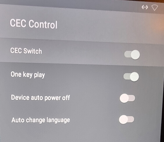

Doh! I booted into Minix Android and turned everything off related to sleep, though most was already. But it still sleeps. ![]()
And CEC too. Prob not related from Android side but ā¦ā¦..
