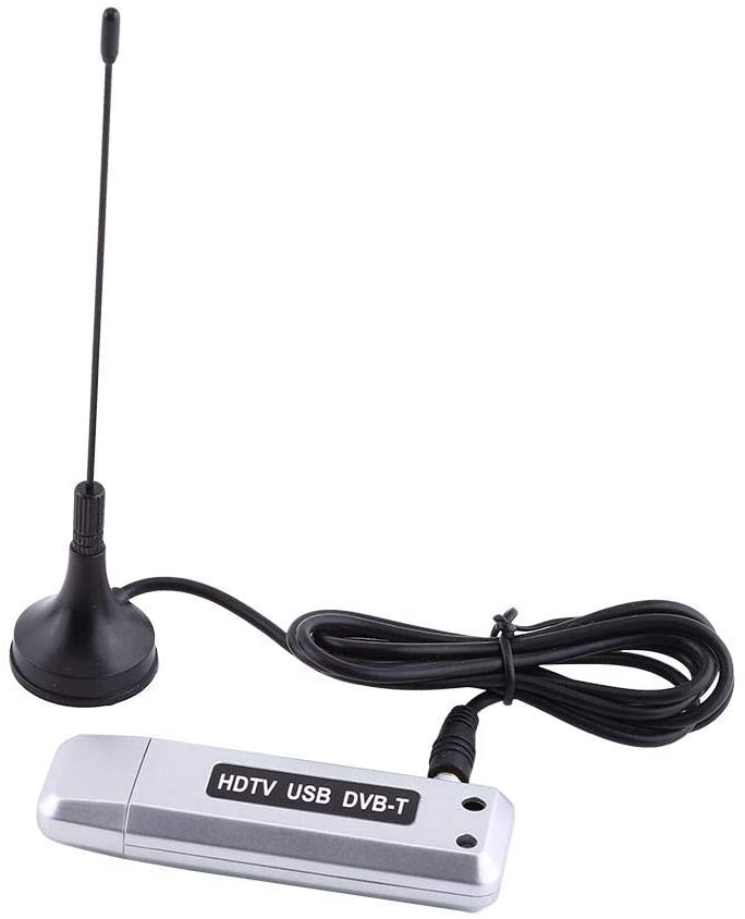

DVD drivers are latest kernel media build. I tried with CrayCats addons, same result.
I studied the log and it looks like either a framebuffer issue, an issue with inputstream adaptive or a hardware compatibility issue.
You do know what those drivers are for, right?
All widevine add-ons use software decoding, others like youtube hardware. So it’s maybe related to the missing power of the SoC it can decode smoothly.
It’s no connection to DVB drivers as they are only for DVB hardware, nothing else.
Yes I do.
I mention it in case it’s related (FYI: for this device you need the media build).
