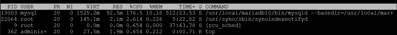

My setup:
Odroid-N2 with CoreELEC 20.0 connected to Amplituner Denon connected to TV.
Kodi database Maria DB on Synology NAS.
Library on the same Synology NAS accessible by NFS.
I started watching a concert with chapters and as I started jumping back and forth through different chapters, Kodi eventually started to freeze, but once everything was fine, I noticed that Maria DB was using almost all the CPU power on the Synology NAS. There was still high CPU usage even a few minutes after I stopped watching this concert, so I finally decided to restart Odroid-N2.
I don’t recall the same issue with CoreELEC 19.5.
Later on today I will try to reproduce the issue.
