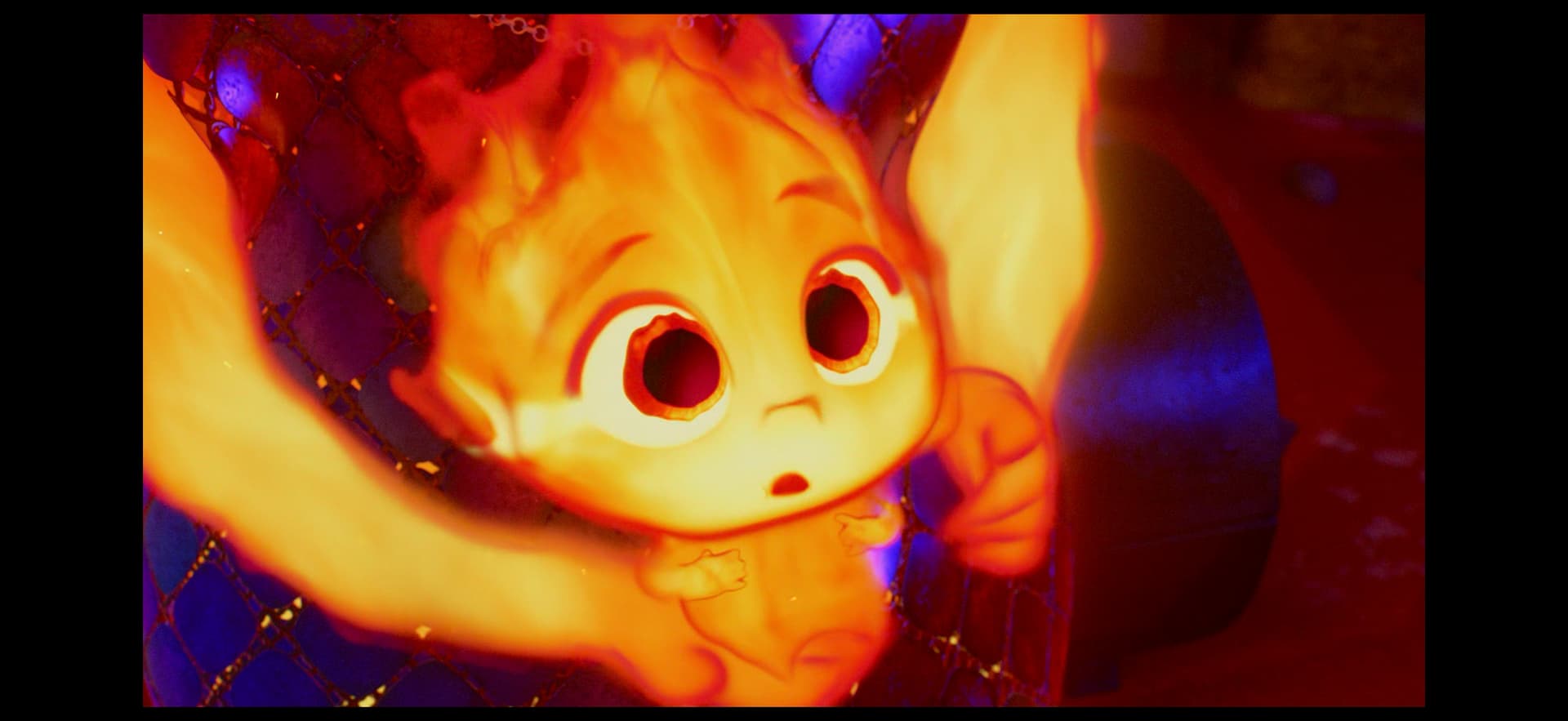

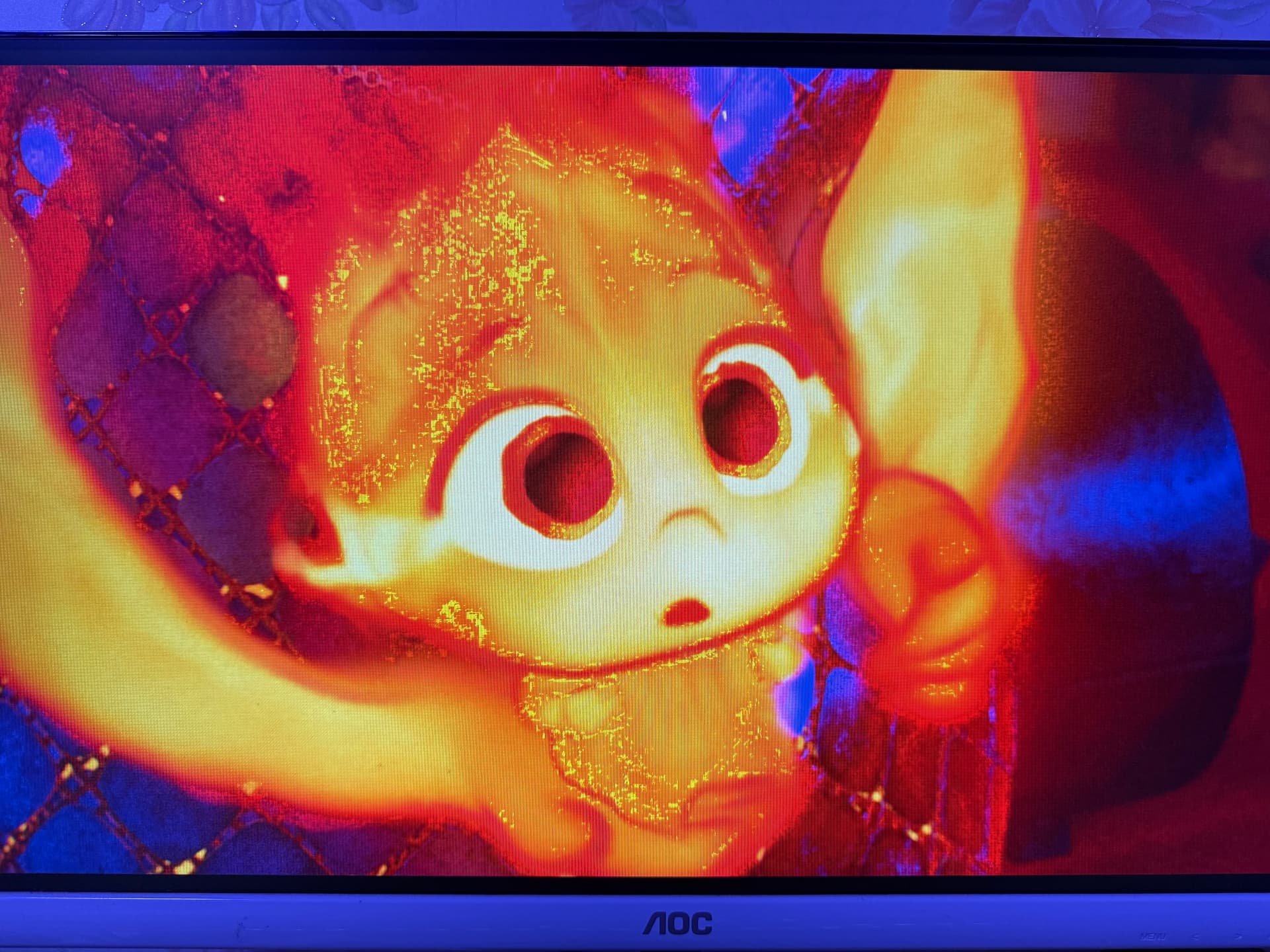

My display device is a Sony TV that does not support HDR, and my playback devices are two set-top boxes equipped with S905X2 and S928X chips. Before version 22.0, CoreELEC’s HDR to SDR conversion was very dark and the effect was not good. However, after testing CoreELEC 22.0, I found that its HDR to SDR conversion effect is excellent. The colors are very vivid, but there is a fatal flaw: there are flickering light spots in some parts of the picture, which seriously affects the viewing experience. I’m not sure how to upload images from my TV to demonstrate this issue, but the phenomenon should be easy to reproduce. I connected the playback devices to my computer monitor and conducted tests, and found that the results were the same as on the TV.
The first image shows the playback screen from CoreELEC, while the second image shows the normal playback screen from an iPhone.
