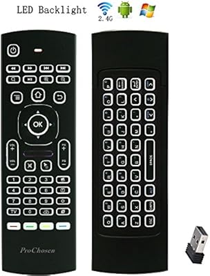

I’m afraid moving from Android and getting started on this stuff can seem very daunting. Either you need to do a bit of reading or you can simply get a decent cheap 2.4G remote which will work straight away without any hassles.
I use this one…
Just plug it in and go. About a tenner.
(Edit) - This also has 5 learning buttons so you can use it to switch your box on/off.
