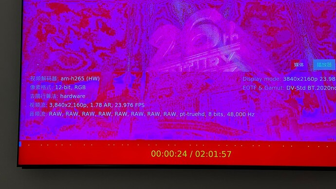

I try today,some movies perfect but some not, and some resume the color is purpel.

I have noticed that sometimes it would play with purple colors, stopping and starting playback will often fix this.
tested a lot fel,about 1/3 purple,from start to the end,stopping then start still like this

I found a bug, those remuxs movies purple, the codecinfo is 12bit RGB, the correct may 8bit RGB!
and i found,playing hdr10 movies,it’ll be 12bit yuv 444,not 10bit, yuv 420
