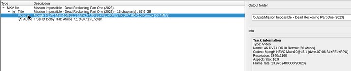

I managed to acquire that exact same movie and when you load it into Makemkv it says this:
MakeMKV v1.17.6 win(x64-release) started
Opening files on harddrive at T:/Movies/2001.A.Space.Odyssey.1968.2160p.BluRay.REMUX.HEVC.DTS-HD.MA.5.1-FGT/2001.A.Space.Odyssey.1968.2160p.BluRay.REMUX.HEVC.DTS-HD.MA.5.1-FGT.mkv
Hack: Found secondary video stream with RPU, assuming DV EL
Hack: Attaching DV data from second video track to first one and discarding second video track
So it looks like Makemkv can recognize these “bad” MKV files. If you then do the remux with Makemkv, you will get a new STDL MKV with BL+EL+RPU:
HDR format                               : Dolby Vision, Version 1.0, dvhe.07.06, BL+EL+RPU, Blu-ray compatible / SMPTE ST 2086, HDR10 compatible
