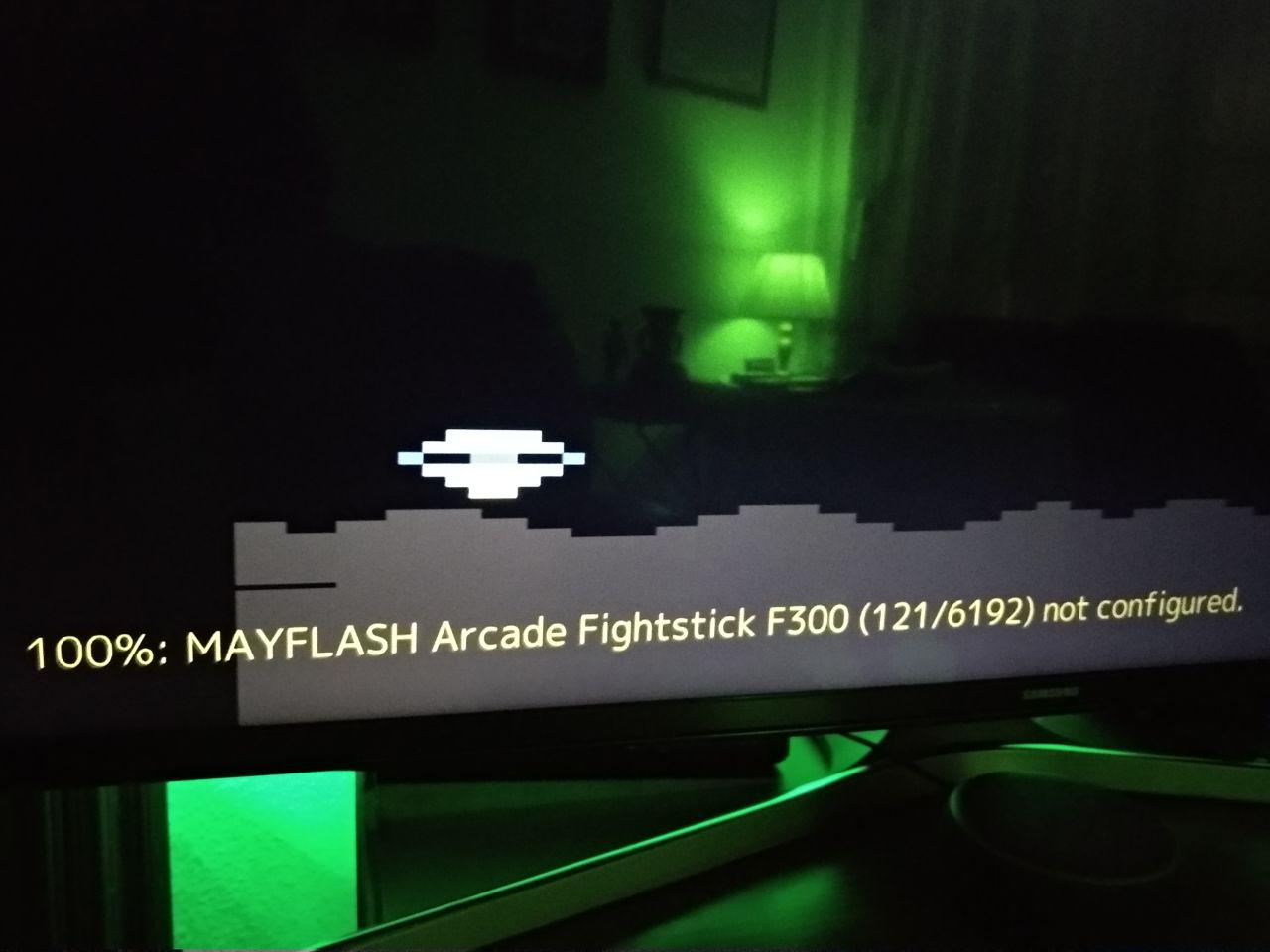

Doesnt work on retroarch,only on menu emulationstation.
Right after you configure your gamepad, can you SSH to your box and send me the result of this:
cat /storage/.emulationstation/es_log.txt | paste
http://ix.io/1G7d
I meant to reconfigure your gamepad
go to configure input int he main menu, and reconfigure your game pad, then send me the link to the log
http://ix.io/1G7f
the auto conf is not firing, what version are you using ?
if you are using 2.5 and if you don’t have any configurations that you want to keep, while in kodi (the addon not running) please try this: ssh to your box and type
rm -rf /storage/.emulationstatiion
now start the addon again and you will be asked to configure your controller, and it should fire the scripts.
Perfect this works! my version is 2.5.Thanks very much!!!
