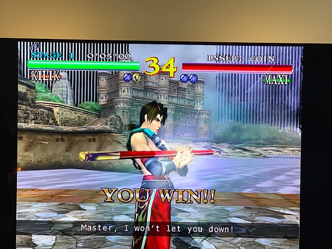

Question. As there are no settings like RArch, Is there a chance to get rid of the flickering in background?! There were the vertical lines are. All other graphics are fine. But in the background this glitches flickers. System S905 - Dreamcast Emu on AddOn Version 2.5 - Game Soul Blade.
This happens more or less in other DC Games too.
There is a new version of the dreamcast emulator that works way better than the one I included, unfortunately it does not run very well on the S905.
so for now, this is as good as it gets :frowning: some games works good, some of them don’t

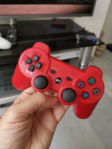

I’m trying that this controller works in emulestation, I pair the Bluetooth controller in coreelec but after doesn’t work on ES.
Any help?
At back its model CECHZC2U
Unfortunately I have no such controller, so not sure how to help.
Thanks for answer if anybody is using this controller and know how to do working in ES, please tell me. With my Xbox 360 with wire works perfect.

How are you pairing the controller?
I have two of these and was able to get them to work in ES (I use RetroArch myself however).
The process for pairing these is listed on the RetroPie site and this is what worked for me in ES on SX05RE:
(Removed the link because it might be confusing)
Basically, plug the controller into a USB port via USB mini cable; the controller will vibrate and buzz. Wait a few seconds, remove the cable and it will pair via Bluetooth.
That said, it would appear that at least one person has reported issues with pairing these controllers on a RPi3 with Wifi enabled (turning it off fixed that issue for them):

That is the way I use it to pair the remote with the box, but doesnt work on ES, only one time works but only recognize a few controls, I have two remote of this brand and happens the same.
I plug the remote by usb to the box and after I check that bluetooth remote is on, I watch the red pilot on in “1” and go to Emulationstation and I try to configure the remote but doesnt work, I plug my xbox 360 controller wired and perfect.
