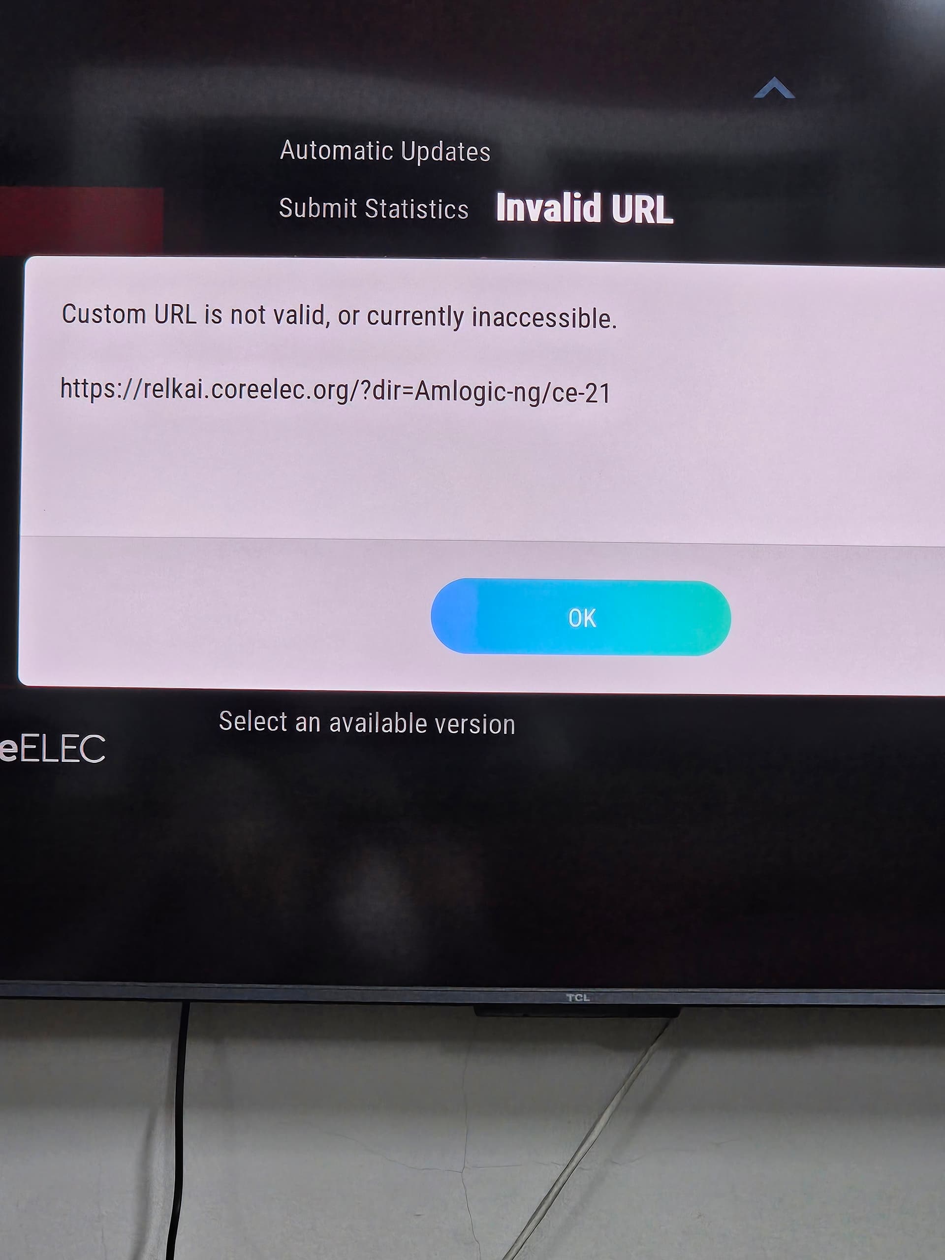

How to enter valid url for custome chanel in Updates setting?
