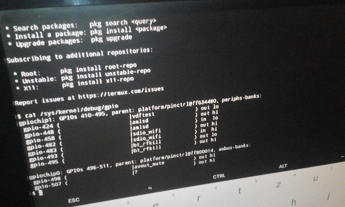

So I ran cat /sys/kernel/debug/gpio and got command not found, great. However I noticed terminal emulator listed it as a A95X_R2 so I tried that config and DTB and it worked, time, colon, icons etc all great. You can update that Config to say it also works on the Goobang Doo XB-III.

Can you post the output of cat /sys/kernel/debug/gpio in Android?
Like here

The difference:
X96 MAX gpio-474
My X96 Air gpio-424 port
No, we were never able to get the vfd to work on that box.
The .dtb modification required.
It’s not a DTB problem. There is no way to determine which pins the vfd controller uses.
