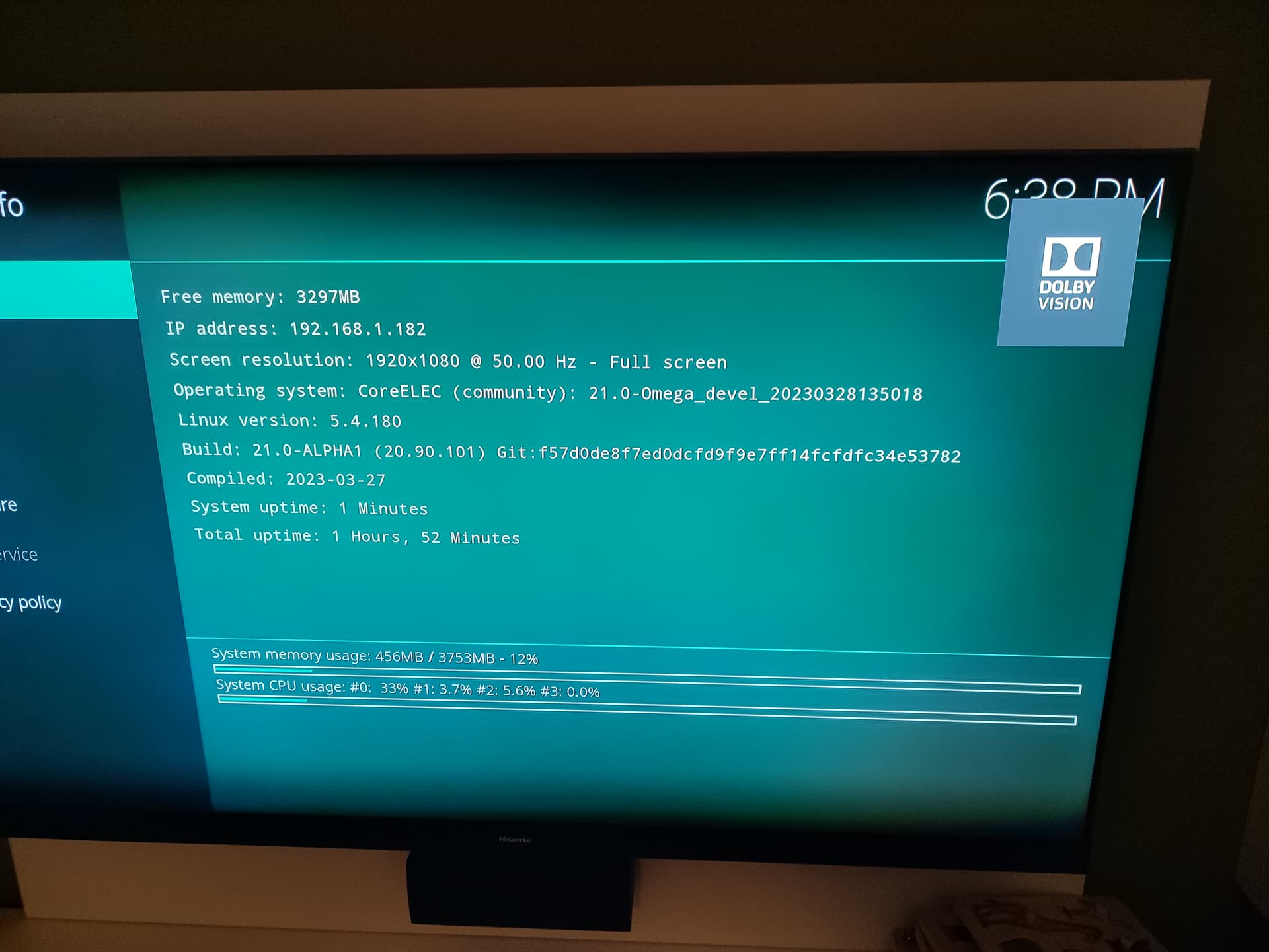

First steps…
Man, that’s :atom_symbol: blast! :atom_symbol:
At last :sunglasses::+1:
Carry on friends.
:kissing:
Wow! That’s exciting. Can you confirm which box this is exactly?
exciting news
