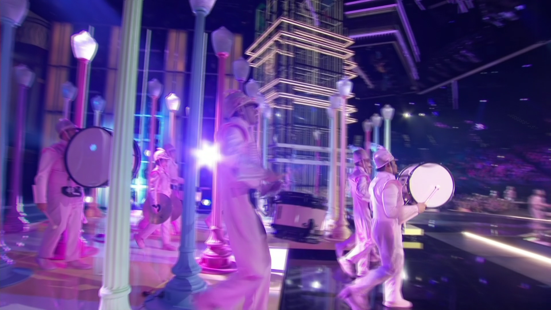

I have a video that deinterlace not working,
I don’t know this is a known issue or not.
THX for reporting bug in deinterlacer. Deinterlacer is reporting progressive content for this video.
You can verify it during playback by shell command: /sys/class/deinterlace/di0/frame_format
it said: Permission denied
Try cat /sys/class/deinterlace/di0/frame_format
CoreELEC (official): nightly_20190827 (Amlogic-ng.arm)
CoreELEC-VIM3:~ # cat /sys/class/deinterlace/di0/frame_format
progressive
Yep, exactly what @afl1 said
The sample is interlaced and for ex. is recognized by Apple TV 4K as interlaced video.

I tried this but it didnt work, Might be 2 reasons.
Is the image only for use with SD Card?
Same issue with that video on S905X (kernel 3.14).
You need to use the DTB from CoreELEC. Don’t go mixing and matching DTBs across different OSes because they are not cross compatible.
Use CE DTB for CE.
