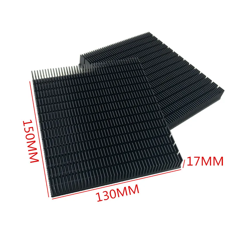

I’m sorry that I can not help you, I bought this at taobao
and I cut two pieces
Your cutting of the heatsink perfectly matches the original case, did you use a thermal pad between the heatsink and the board?
yes, I use a thermal pad between the heatsink and the board

I am impressed you got such temp jump by heatsing from the BOTTOM of the SBC… Thats great news, as there is very easy to attach any custom heatsink on the top of DIY plate.
