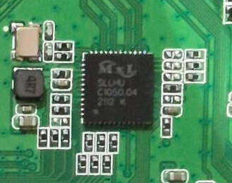

Thanks for helping me realise that I could also post an image here instead of finding out what to look for myself!
Hope this gives an idea if I have the right hardware for this or not? If not I think it’s not too hard to get a USB Ethernet adapter anyway, and I’ll likely get better speeds than the expected 100Mbs anyway.
Actually yours does have a “missing” chip by the SD card slot that Zuma and I have, so there are different revisions of the box.
Yes correct
Where is Max Linear ethernet transceiver???
My image is bad but that would be on Zuma’s

Your device do not have a eth chip assembled.
You would need to make a Android dmesg log.
And extract Android DT: coreelec:devicetree [CoreELEC Wiki]
Or even better a UART log. The pins are on the right top of your picture.
Mine works over 450mb/s using Portisch NG file.
On NE it is only 100mb/s and no wifi in menu.
I am going to try an usb to eth when it arrives.

Portisch has addressed user womars issue with missing chip
Kinhank set internal and external phy the same time in Android DT.
This does not work for us as the kernel would need a hack for this.
So when the bootloader does not signal what is assembled it’s not doable.
Run fw_printenv | paste and print environment for such G1 device without eth chip.
