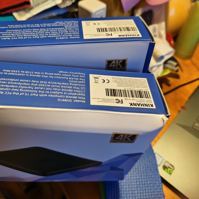

I bought two box from kinhank official store from AE and I installed hungphutho easyly both . I received the last today and I use hungphutho without issue too (the first box from Kinhank GLOBAL STORE and the 2nd box from Kinhank OFFICIAL store)
How lucky you were!! No password required for your product? Will you keep these 2 boxes, I would be ready to buy one from you :grin:
Yes … no password required. Upgraded with Hungphutho straight. Did you buy your from kinhank store official ?
