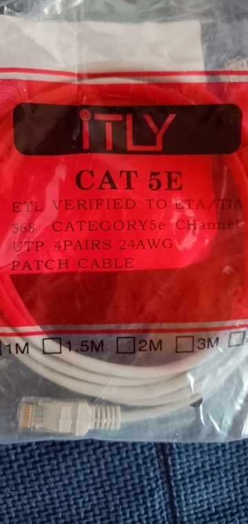

I’ve searched through AliExpress to find a bundle to get the cheapest in case anyone is interested
$3.59 (pick USB3)
DBIT Wi-fi Adapter 3.0 USB HUB Ethernet Type C To RJ45 Gigabit Network Card Mini PC Desktops Laptop Accessories Plug and Play
$0.89 (pick 2 metres for $0.89 or you can pick longer cables for more $)
Cable Ethernet De Alta Velocidad Cat5e RJ45 Cable De Red LAN Enrutador De Ordenador Patch Cord , 1M/5M/10M/15M/20M/30M/50M
$1.39 (pick Color: CP2102 Cable)
CP2102 USB 2.0 to UART TTL 5PIN Connector Module Serial Converter STC Replace FT232 CH340 PL2303 CP2102 MICRO USB for aduino
total for Uart cable + 1000Mbps ethernet adapter + 2m ethernet cable is
$5.87 pre tax and free 6 day shipping , shipped by aliexpress
You can buy longer ethernet cable or if you need another item , say SD card you can search for another choice item (3 choice items needed to hit free shipping)
you don’t need to buy anything else for this bundle to get free shipping.
not bad to pay an extra $5.87 (pre tax) to make sure you pretty much will have a working G1.
Just trying to help out.
