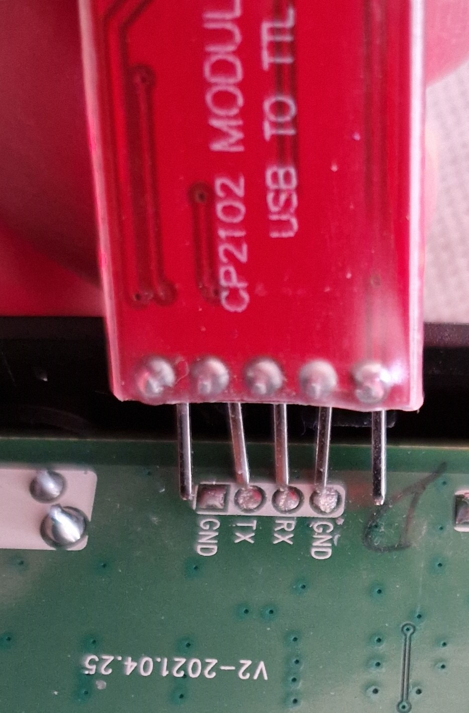

I made a mistake and copied something wrong to G1 so it doesn’t boot anymore but says ‘make your life colorful’ on the TV screen.
I bought a Cp2102 usb to uart on Aliexpress, installed Silicon Labs driver (11.4.0) and PuTTYPortable on my win11 computer.
The Uart is connected to G1 as in the picture (gnd, rx, tx).
After turning on G1 I tried to pause for two to six seconds before short-circuiting D0 but the PuTTY window remains black.
What could be the cause of the failure?
It’s hard to see, but I think you need to turn the uart adapter 180 degrees!
The correct connection is:
GND - GND
RX - TX
TX - RX

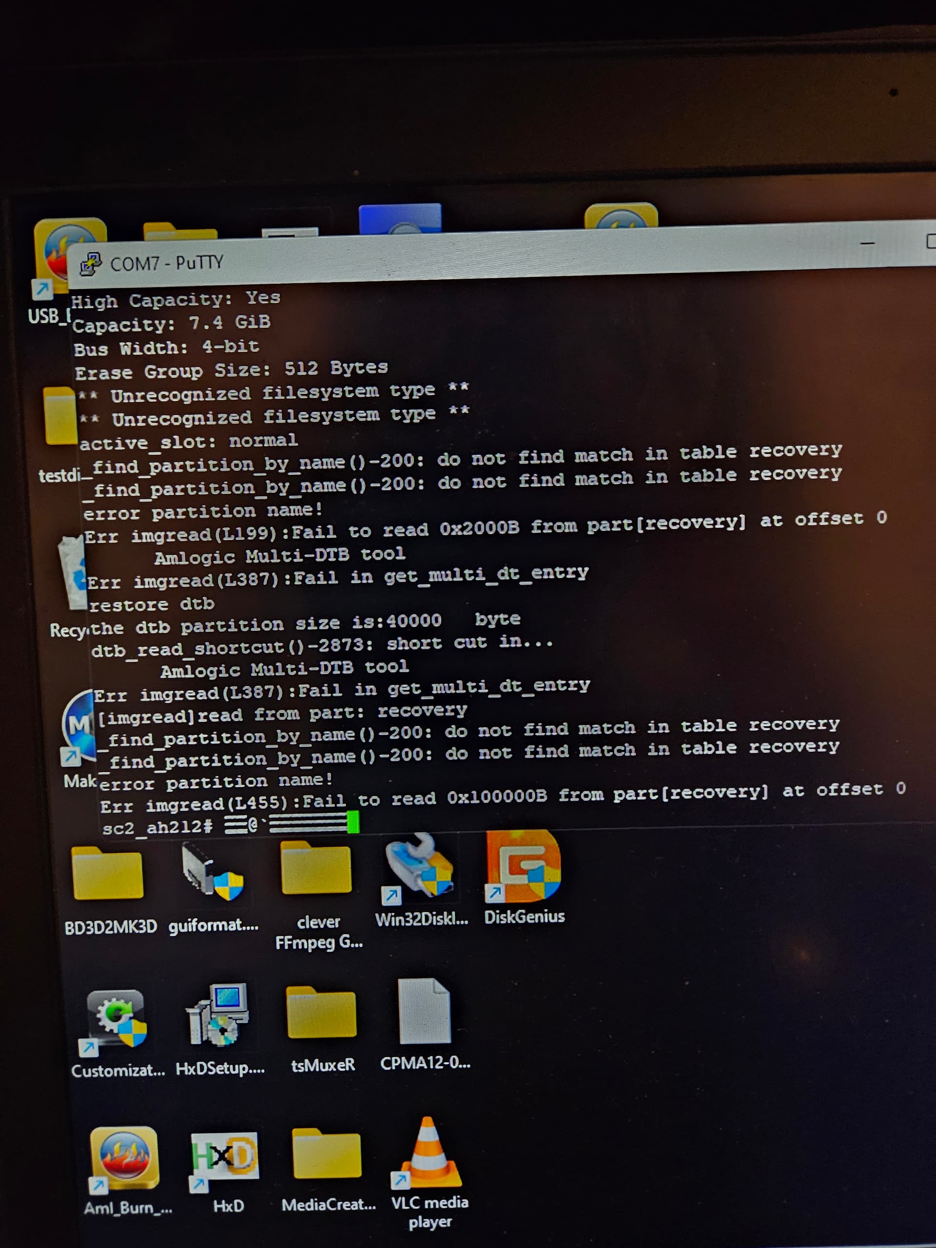

What am i doing wrong? :confused:
SD card file system must be formatted as FAT32 type
It was fat32 before, had same msg so tried exfat, ill change back & try again, thx
